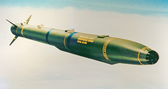

Back in the very early 90s a friend of mine who worked at Marconi was involved in an anti-armour weapon then known as Brimstone. The project had progressed enough to have some very swish publicity pamphlets and stickers produced (the latter particularly memorable as the logo was a witch on a broomstick crushing a T-72 in her hands), and I saw some very impressive video footage of test firings. Now, the thing is, this Brimstone was a skeet submunition dispenser - much like the AGM-145/BLU-108 combination the USAF now use.
Whatever happened to it, because the MBDA Brimstone is clearly a very different weapon indeed?

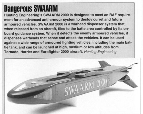

Does anybody know who was making the MMW seekers for these submunitions? I am guessing that Marconi made their own but where did Hunting get theirs from? And who made the submunitions? Apparently the SWAARM submunition had an IR seeker as well as an MMW. Of course there was also the Thomson-Thorne TAAWS in a similar category.
I can see I'm going to have to dig through the boxes in the loft and see if I can find the publicity pamphlet! Thinking about it I was probably off saying early 90s - it'd have been late 80s when I saw the videos of the test firings. I distinctly remember the test shots leaving a near-vertical smoke trail over the targets, with the targets exploding nicely, and Marconi titling at the beginning so I don't think it would have been tape of SWAARM though the description of the latter does sound much more like the weapon I remember. The timeframes don't fit very well either with the current Brimstone being little more than paperwork at the time I saw the tape and publicity material. Strange...
The first AST.1238 proposals were intended to be quite complex weapons, either missiles or submunition dispensers. When cost cutting took over in the later 1980s these weapons were abandoned in favour of other, lower performance/cost proposals - Hunting proposed SWAARM and Marconi Brimstone (see SOC's link above).
In the early/mid 1990s further changes post-Cold War/Gulf War etc. led to Hunting proposing SWAARM 2/2000, using Honeywell submunitions and the Swedish/German KEPD 150 body IIRC. I think I have seen patches for these (and the story is told further) in Always a Challenge: An RAF Scientist in the Cold War Years - A First Hand Account by T.H. Kerr.
As far as I can tell, from about 1986 on, Marconi/GEC were pushing Brimstone as a Hellfire derived MMW weapon. They had lost out in the early AST.1238 work to BAe and Hunting so this was their way back into the competition, selling 'low risk/cost' I guess. As time progressed, and Brimstone developed from being just a Hellfire with a MMW seeker bolted on, and came to share only the Hellfire layout (all new inside), I guess the costs and risks went up!

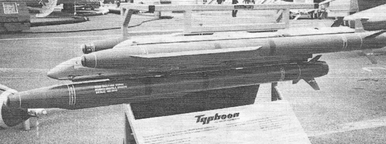

Loads on JP. 233 and SR(A) 1227 and 1238 in Typhoon to Typhoon. I'd love to see a drawing of a Buccaneer or Canberra runway ripper-upper with the depressable(?) KCA cannon.
