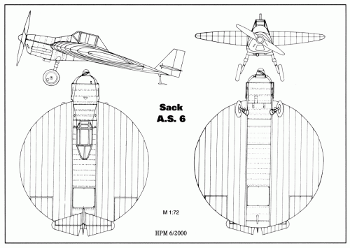

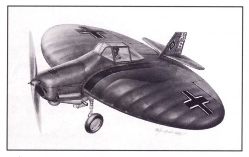

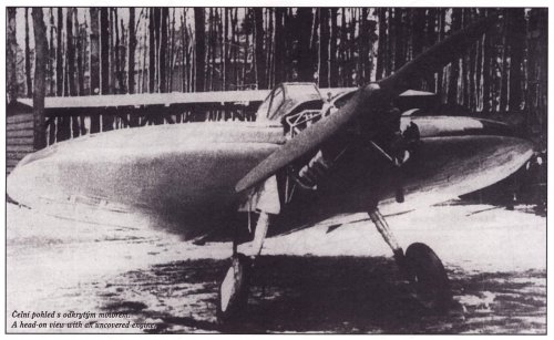

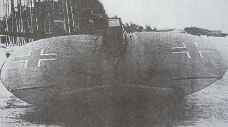

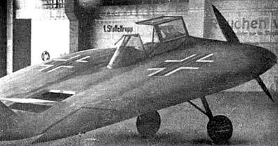

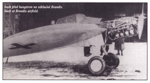

Here is a set of pictures of the Sack A.S. 6. This was designed and built during the war.
I'm not aware of any later design by Sack, but I could be wrong.

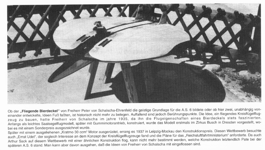

From Flugzeug Profile.

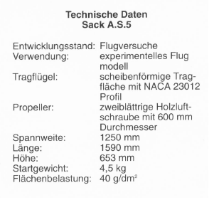

The Sack AS.1,2,3,4 & 5,
