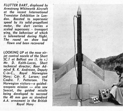

it's an Armstrong Whitworth Flutter Dart, but with a straight wing rather than the swept shown here:
Chris
Witht he name, Skomer has an entry and a description:
http://www.siouxcityjournal.com/news/national/article_2672c6bb-91f3-59f1-85e4-c9f1fe23948f.html
"Rocket boosted winged vehicle to investigate aero-elasticity."
Makes sense that they might try various different wings for comparison. A simple straight wing would be a good baseline, since it's so well-understood.
Don't go betting the rent on Skomer. Long past its use-by date.
Chris

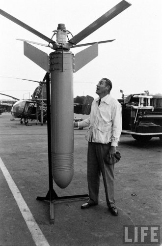

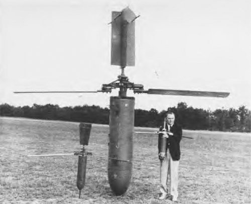

Found this on a Forum
look like bomb with a rotochute
or is this a sonar probe ?
Ha! That shouldn't be too difficult... The man standing next to it is Charles Kaman!
This is one of the KRC- Rotochute test vehicles.

BIG THX for Info !
do we have not a threat about Charles Kaman Rotochute ?
Michel Van said:
BIG THX for Info !
I think it is somewhere on this forum, yes. In that case, let a mod merge the two and remove my duplicate attachments accordingly.
