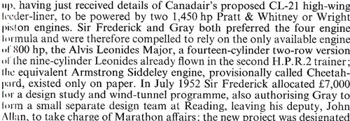

I found this, from Putnam's 'Handley-Page', page 531, the Leonides Herald chapter :-
"...having just received details of Canadair's proposed high-wing feederliner, to be powered by two 1450hp Pratt & Whitney or Wright piston engines. Sir Frederick and [designer E.W.] Grey both preferred the four engine formula, and were therefore compelled to rely on the only available engine of 800hp, the Alvis Leonides Major, a fourteen-cylinder two-row version of the nine-cylinder Leonides already flown in the H.P.R.2 trainer; the equivalent Armstrong Siddeley engine, provisionally called Cheetah-pard, existed only on paper."
So it does indeed seem that 550-580hp is too low for the Cheetapard, and that the true rating is 800hp.

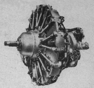

@Hood; according to Wiki, the Cougar was a single-row, nine-cylinder engine, bore and stroke 5.5 x 5.5", giving 850hp for take-off, 500hp cruising:-
Also, the Cougar was under development in 1944-45, whereas the Cheetapard was still 'on paper' in 1952, ref. as above, page 530.
