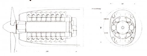

The second image (also from "Der Flieger") shows a quite similar air-cooled Argus engine, labelled as As-403(sic), comparing favorably its dimensions to the radial BMW 802 ( Lenght: 2,25m; width 92,5cm, eight 1,14m) which, according to "Flugmotoren, was 3,095 in lenght and 1,5m in width.
Now, it shows eight cylinders in each bank, making it a H-32 projected aircraft engine I never heard before, most certainly a spin-off of the As 403.

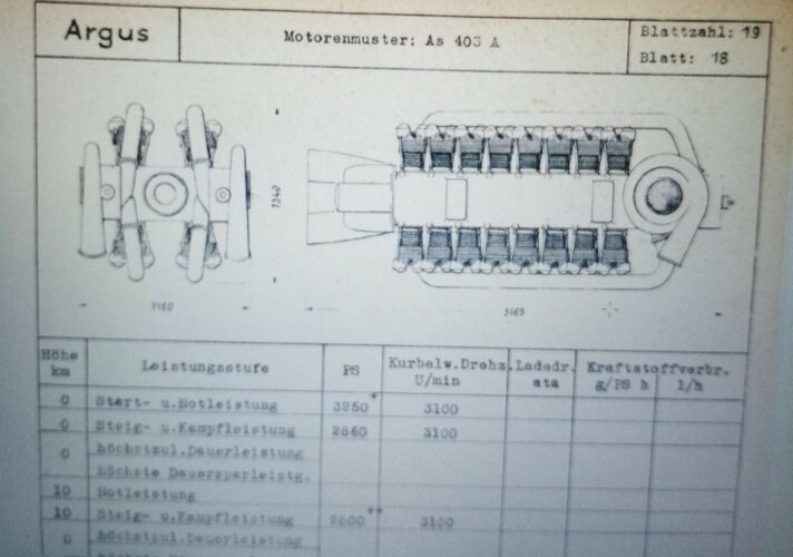

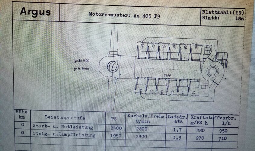

From "Argus Motorenmuster", dated June 1941. The first one is the As 403 P9, first known to me through Jane`s. The Hp matches, 2500 h.p. The second one is the Argus As 403 A, which matches Jane`s P5 at 3250 h.p.
