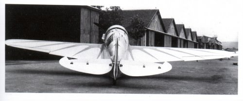

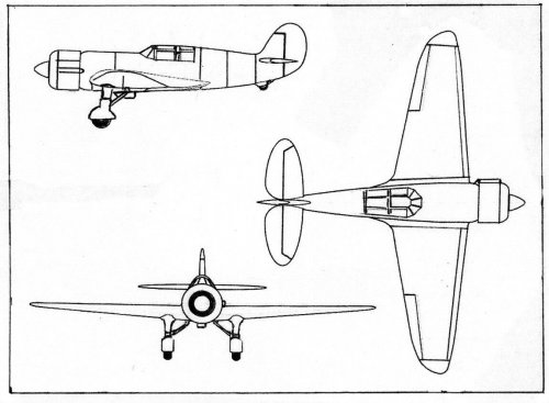

In the quoted feature, Gregory describes the SCA (Società Costruzioni Aeronautiche Guidonia) AQV or Tipo 3 (perhaps for SCA.3). On that issue of 'Aero Fan' are three photographs of the AQV (that I enclose). How was possible that an aircraft was built and testes by a state organisation without any trace in public archives is another interesting question...
My post it's only to remember to our community that the aircraft had the Matricola Militare (serial number) 422 but that there are indications of a second prototype under construction in 1937 (apparently withhout MM) and that in military archives are also quoted two SCA.2, perhaps a previous iteration of the same project but I lack any information about.

according to researachs done by Gregory, the misterious AQV performed 36 flights (the first on July 6, 1940, when Italy had just entered WW II, and the last one on November 7, 1941); tha max altitude reached was 7,000 m: evidently no altitude record was attempted.
From a technical point of view, the aircraft was of all-metal construction. Its power plant was a Piaggio P.XS Stella (S, perhaps, stood for Stratospheric), a 9-cylinder radial engine that was a modified copy of the Gnome-et-Rhône GR.9K Mistral, with reduction gear and two-speed supercharger, rated at 700 HP.
The only known technical specifications are:
Span 9.36 m
Length 7.93 m
Height 3.00 m
Wing area 22.52 sq. m
Take-off weight 1,950 kg
Max speed (project) 485 km/h
Maximum ceiling (project) 8,000 m (ma there are also indications of 13,600 m)
Range (project (1,060 km)

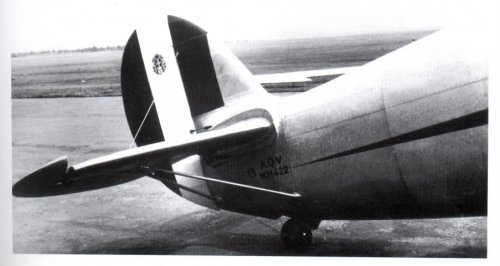

I can add this rather crude three-view drawing of the SCA AQV.
Surely our friends Archipeppe and MC.72 will be able to do better...

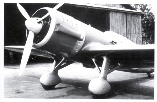

As we can see in the pictures I posted some months ago, the aircraft was painted silver aluminum (Alluminiata in Regia Aeronautica parlance) but the airframe sported also a flamboyant trimming that I think could be azure blue; the pictures are reworkd several times but is seems to me that the grey tone of the trims was lighter than the ones of the Italian flag on the rudder. Moreover, we know that the Ca.161bis of the the same high altitude unit was painted ivory with azure blue trims...
