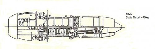

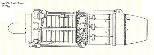

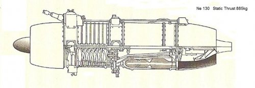

I don't have any drawings or other images of the 230. I do have the Ne-20, Ne-130 and Ne-330. You can at least see the progression.
