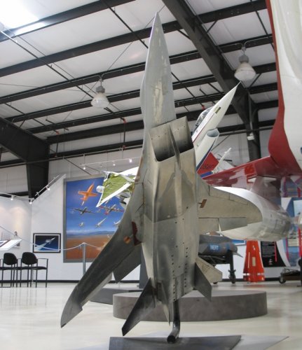

The original ten by twenty foot painting is on display at the Air Force Flight Test Center Museum at Edwards AFB.
Attached is an image of some of the museum displays with part of the painting visible in the background (sorry about the clutter in the foreground... <smile> ).
verner said:
I don't see an F-107 in there.
That's because it isn't there. ;D
North American Rockwell NR-335, the contender for the FX (F-15) program.
