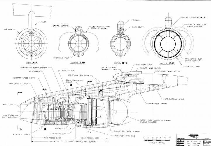

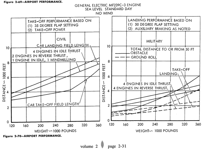

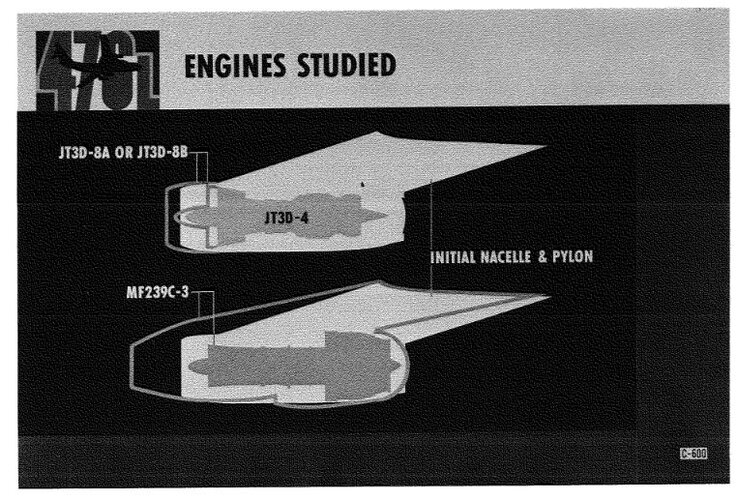

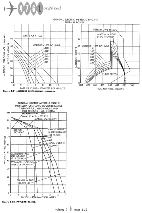

Attached is a schematic comparing Lockheed 476L (future C-141) engine installations.
Source: 476L Super Hercules - GL207-45 - Briefing Summary, page 3-24
