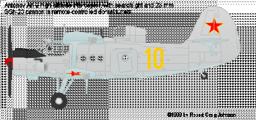

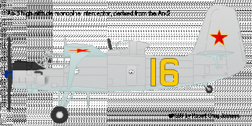

Found a website sometime ago about a variant of the AN-2 that was designed to shoot down U.S. GENETRIX Spy balloons. It had a turbo or supercharger to fly at high altitude. A rear turret was added with a gun.
Website had some great side views. Don't think it was ever built.
Probably this old site:
http://web.archive.org/web/20080405194629/http://worldatwar.net/chandelle/v4/v4n1-2/balloons.html

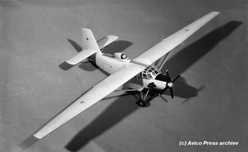

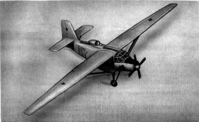

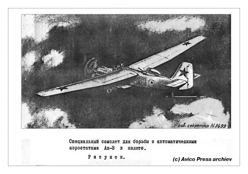

Аn-2A or An-3 first with this name

Stephane, this is the An-3 (the first of that name)
If the source of this picture is the thread
http://www.secretprojects.co.uk/forum/index.php/topic,11520.0/all.html
this is one of the errors Hesham, incorrect translation.
