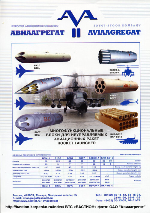

there was such project in 90-s -
this may be the development

On Russian forums they're saying it's a field (Chechen war) modification of the Strela-10 used for forward airfield defence. The larger launchers are for flares while the smaller ones are for S-8 rockets. The idea being to light up the perimeter of the base and deal with any encroaching guerrillas.
The use of aircraft ordnance is for practical reasons. The flares and rockets would already be stocked at the airbase.
