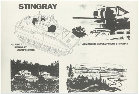

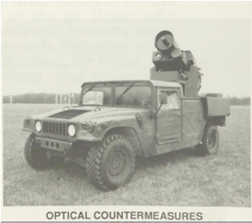

Thinkin Stingray was cancelled and may be mentioned elsewhere. There is/was ongoing research into manportable Optics finders.
