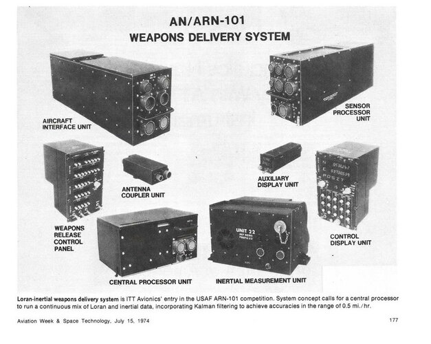

Here are the Lear-Siegler and Litton submissions for the ARN-101 competition. Both included inertial.

Incidentally the INS selected for the ARN-101 was the Kearfott SKI-2300, beating Litton's submission.
The default mode was for LORAN-C/D to periodically update the INS. In the event of a scramble, the INS could be aligned in flight entirely from LORAN in about three minutes.

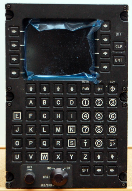

Initially, I thought that the ARN-101 was the last nav system with CDU before the classic Phantom II jets were phased out in the US. However, at http://www.f4phantomparts.com/NAV.html there is a picture of an alleged F-4's CDU by Smiths (image hot-linked below), which clearly shows the operational mode knob to include the Doppler, INS, GPS or INS/GPS mixed mode, albeit without Loran. Do you recognize this FMS? Was it indeed used in the F-4s?
