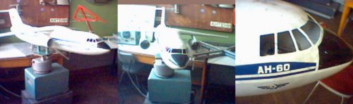

Model of Antonov An-60.
I get confused: the model has just two engines!
Anybody knows the dimensions or other technical data?
Draft of An-60 had 2 engine, this project is then used to develop the An-72.
