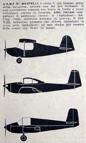

I know the SAI is abbreviation for Società Aeronautica Italiana or Ambrosini,so I found
this Project called SAI P.303,for a low-wing light monoplane,maybe intended for touring
or training role,am I right ?.

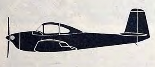

iverson said:
It looks rather similar to the Piaggio P.148 and P.149 trainers.
That's right Iverson,
and what was this designer,Preti and his airplanes ?.
The caption reads:
... Other Italians complete the panorama (below): the 'Saltafossi' ('Ditch Jumper'?) by Engineer Preti, built during the war; the SAI P.303, a beautiful project that was to be built in large numbers (in metal); and a more recent study of the same Ing. Preti (in wood).
The Ing. Preti in question was Ermenegildo Preti from the Politecnico di Milano. Preti designed Ambrosini's post-war horizontally-opposed engines - the 22 hp P.25 and 75 hp P.70. The former powered the GCA.2 Jumbo V-tailled light plane on the previous page (as well as the Partenavia P.53 Aeroscooter, Mantelli AM-11 Albatros, CVV-6 Canguro M, and ... I assume ... the Movo F.M.1 motor-glider also shown on Page 23).
BTW, the CVV-6 Canguro M conversion was a joint exercise between Preti and Col Adriano Mantelli, commander of the AMI's military flight centre.
AFAIK, the Ambrosini P.70 HO4 engine never flew. It was intended for Preti's 1948 PM-280 'Tartuca' single-seat low-wing racer. However, the sole PM-280, I-RACE, eventually flew with a 60 hp CNA D.IV engine.
This link is to a photo of the Ambrosini P.25 and P.70 displayed together at Fiera di Milano trade fair in 1947:
http://www.lombardiabeniculturali.it/img_db/bcf/u3030/3/l/2564_n_1947_1431_pp.jpg
