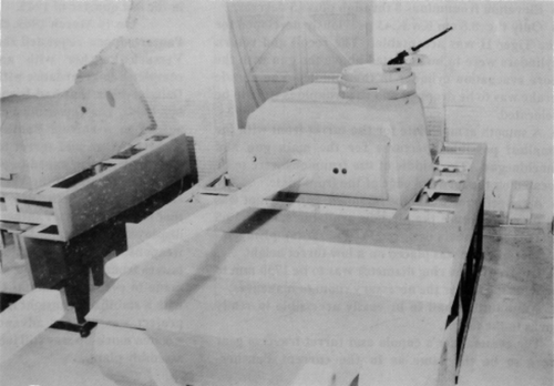

There is an image of the mock-up of the Rheinmetall turret, see below, but does anyone have, or
know the whereabouts of ,any drawings for this turret?
