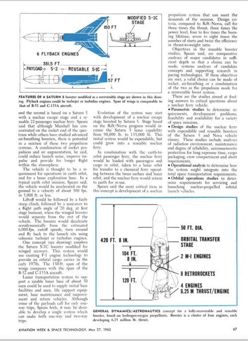

-back in the day (1959-1960) both Convair and Martin thought about wrapping an "aircraft package" around their respective Atlas and Titan. Wing, winglets, jet engines, undercarriage, and the kitchen sink.
-So let's strap a similar "aircraft package" around Saturn S-IB. Which mean Chrysler space division would have to do it.
-Interestingly enough, back in 1960-62 Chrysler wanted to try recovering that S-IBB: except with Ryan Rogallo wing. Bad idea, a Rogallo wing that size would be impossible to deploy in flight.
- So our flyback booster would be mix of the winged Atlas / Titan / S-IC proposals.

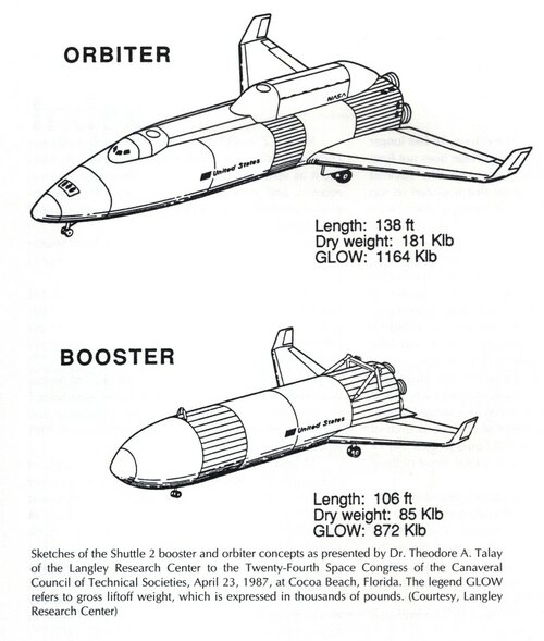

There it is ! Langley's Shuttle II and its unmanned, glideback booster. Through a bazillion of studies since 1974, they had determined Mach 3 was the optimal staging velocity for the booster to return gliding - that is, no powered flight with heavy and voracious jet engines.

Yeah, and so is the Shuttle II booster. Although it would be easy to shrink it. Note that its props are hydrolox: any issue with that ?

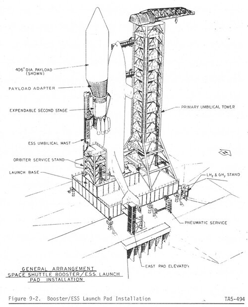

Based on the 1971 MDAC Expendable Second Stage study, from back when the Shuttle Booster was going to be a flyback stage and the Orbiter carried its own tanks, and a 65klb payload, you're looking at something like three-eighths the total vehicle mass
  • Booster - new LOX/LH2 engine(s), total 1,770 lb thrust, 960klb propellant
  • Upper stage - 2 x J-2 or equivalent, 290 klb propellant
That's a decent sized rocket, but not at all unreasonably so. The booster probably gets 3 x OTL SSME, or 4 smaller ones. Playing around with sizes, something like a 320klb engine would work with six on the first stage and one vacuum-optimised engine on the upper stage.
One F-1 derived engine would also work for the booster, but I think that LOX/LH2 would be preferred for 'efficiency', as it was with the OTL Shuttle.
If/when a small orbiter for this system was funded, it would carry maybe 10klb to orbit with 2-3 flight crew. Really a space station ferry craft; I'm assuming you'd get some kind of crew module for the payload bay.

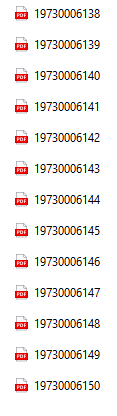

Sweet geez... it's a 12 volume study ! I downloaded all 12 pdf files. Way too big for this forum, I'll try my chance at NASAspaceflight.
Ah, they've clearly made the whole thing available then - I only have Volumes I, Volume II Book 1, Volume VIII and Volume IX. The titles of the documents are, for anyone wanting to check it out,
  • 19730006138 Vol. I - Executive Summary
  • 19730006139 Vol. II - Technical Summary - Book 1 -Expendable Second Stage/Reusable Booster System Definition
  • 19730006140 Vol. II Technical Summary - Book 2 - Expendable Second Stage System Definition
  • 19730006141 Vol. II Technical Summary - Book 3 - Booster Vehicle Modifications and Ground Systems Definition
  • 19730006142 Vol. III - Wind Tunnel Test Data
  • 19730006143 Vol. IV - Detail Mass Properties Data
  • 19730006144 Vol. V - Operations and Resources
  • 19730006145 Vol. VI - Interface Control Drawings
  • 19730006146 Vol. VII - Preliminary Design Drawings
  • 19730006147 Vol. VIII - Preliminary CEI Specification - Part 1
  • 19730006148 Vol. IX - Preliminary System Specification
  • 19730006149 Vol. X - Technology Requirements
  • 19730006150 Vol. XII - Design Data Book
Several of these are probably only important if you actually want to build one. But I don't know how big your garage is, so go for it. Note that Volume XI is unaccounted for, and there may be (it's not clear) additional parts to Volume VIII.

Mach 3 isn't very fast, the expendable second stage...from this picture, from the Aerospace project review...
That can't seem to make its mind up whether it is an upper stage or parallel stage.
Those solids so close-to the fly-back worry me.
Shuttle showed cross-feeding works...might the upper stage be empty and--after Max-Q be fed from the booster?
Upper stage has helium to stay taut that it exchanges with the booster for fuel...flyback returns helium for re-use?
