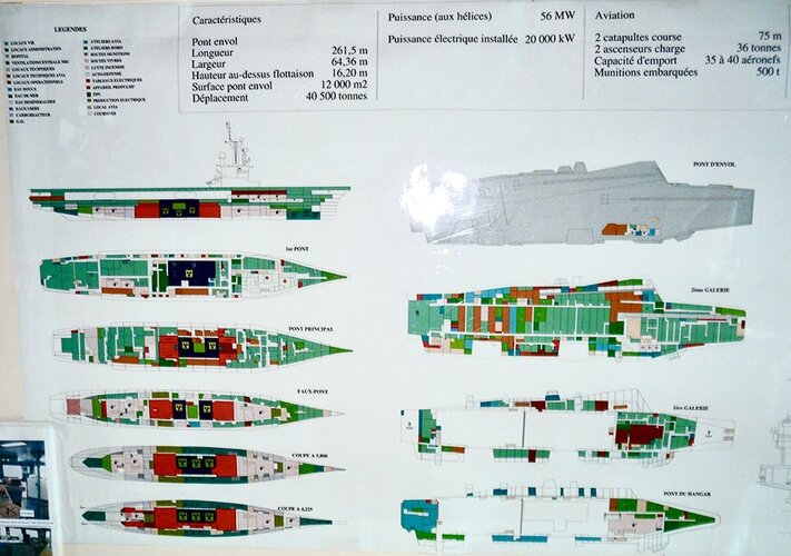

Here are the plans of CdG. A conventional variant wouldn’t be too hard… just reorganize the main turbine rooms (in red) and nuclear reactor section (in dark blue) into conventional gas turbine and auxiliary machinery rooms.
Plenty of internal volume available. Only constraint is routing of the exhaust stacks. This is why in the Indian ADS proposal the island was moved to between the lifts, so that it would be right on top of the machinery rooms.
Here’s another alternative to my initial idea. Instead of the ADS proposal for India (which required locating the island between the aircraft lifts), another option might be a carrier that looks a lot like CdG, forward island and all.
The propulsion would be conventional CODAG. The gas turbines would be located in the forward machinery room (in red) and the diesels would be located in the aft machinery room. This would allow for easy trunking of the GT exhausts up to the island directly above.
With 2x LM2500 gas turbines (20MW each) and 2x SEMT-Pielstick 18V PC2.6 diesels (11MW each), total propulsion power would be 62MW… same as the nuke plant.
