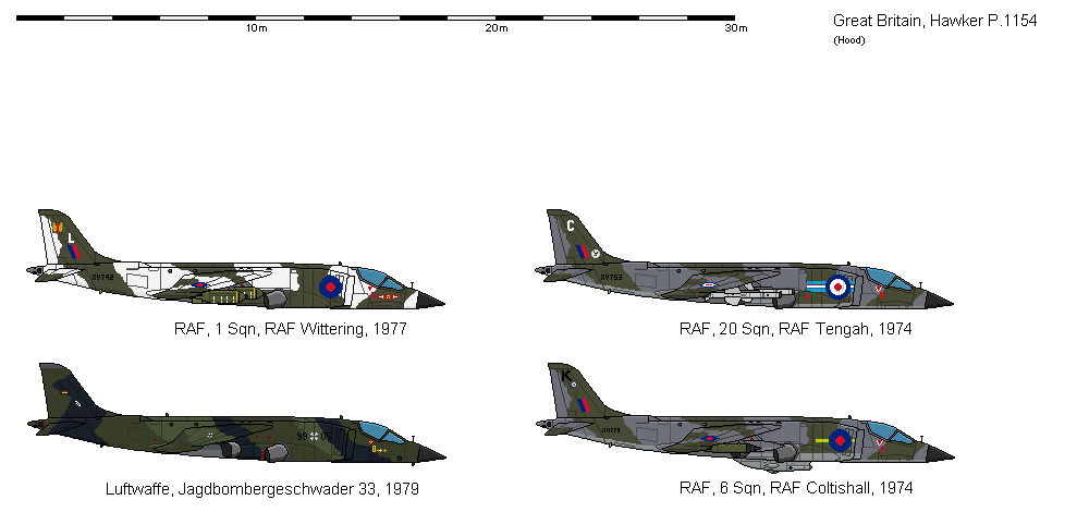

Personally I feel the VTOL fleet idea, which the RAF briefly embraced, to have been a folly even with 1960s technology. Even so its mystified me why, after the tri-nation Kestrel trials, the Luftwaffe didn't buy the Harrier to fulfill the VAK 191 programme? The Harrier might well have been a better solution and really would have offered a good ground-attack platform to replace the G.91 and serve alongside the Mach 2 interceptor fleet. We could go further and imagine a German P.1154!
A little what-if of the P.1154 I've drawn before;
Hood
Thanks for coming back on this one with some fascinating material. Your artwork on the P1154 is brilliant and I know that you have other gems on excellent Shipbucket site.

In the realm of what-iffery however the P1154, VJ 101/VAK 191/AVS and Mirage IIIVs look very smart and thanks to you and John Maverick we can see how smart they would have looked in 70s and 80s camo.
