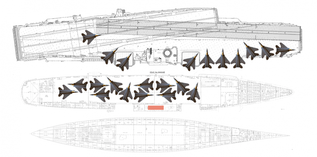

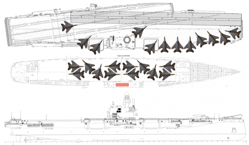

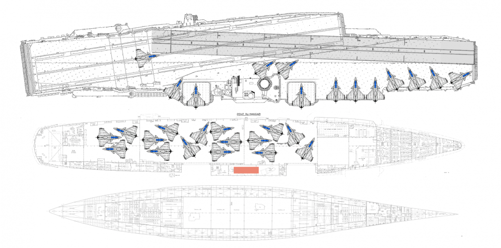

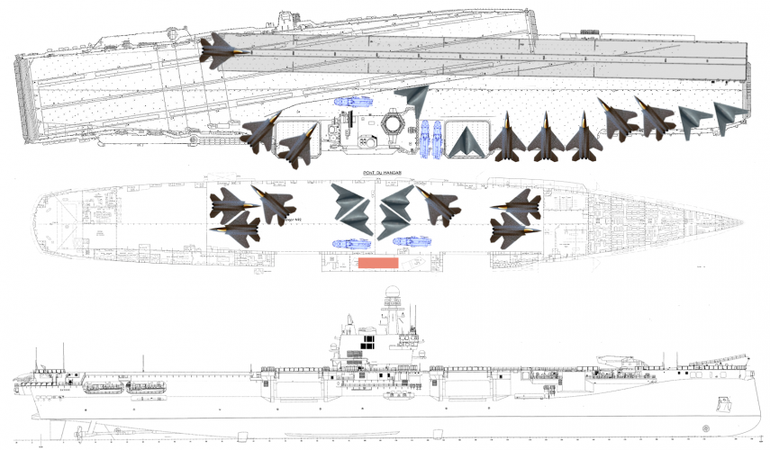

Here is my own take...
- start from Q.E that is, where France stopped in 2008 (I hate to say those words, but... Sarkozy was right on that point.)
Then... engines & catapults combinations
- Option 1 Q.E + K22 submarine reactors + EMALS
- Option 2 Q.E + K22 submarine reactors + licence-build C-13 catapults
- Option 3 Q.E + non-nuclear + C-13 catapults
The main unknowns
- can K22 nuclear reactors power a Q.E to 27 kt at a minimum ?
-I have no idea if a non-nuclear carrier can use EMALS ? those things need so much electrical power, I wouldn't bet on this.
