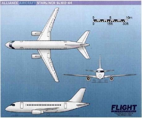

Alliance SL100-44 regional jet aircraft

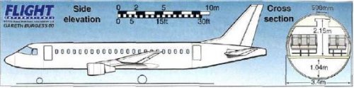

Some more information of the Starliner series project.
Alliance StarLiner SL-400
Length: 35.6 m
Wingspan: 28.2 m
Wing Area: 80 sq m
Cabin Width: 3.45 m
Passenger Capacity: 110 seats
Max Take-off Empty Weight: 44,910 kg
Operating Empty Weight: 22,790 kg
Maximum Payload Weight: 12,247 kg
Maximum Speed: 0.8 Mach
Take-off Distance: 1,829 m
Range 3,710 km with 100 passengers
Rolls Royce BR-700: 2 x 17,250 lb
There was also a Starliner SL-100 which was a 35-50 seat passenger airliner. These were the SL-100-44 and SL-100-50 to be built in the USA at Martinsburg and the SL-100-35 to be built in PR China by HAFEI (the designation suffix denoting the passenger capacity).
