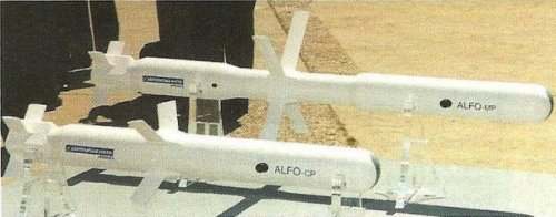

Why was this MBDA project for precision guided rounds for 60mm, 81mm & 120mm mortars cancelled in 2006?
Was it due to a technical problem with the FOG at launch or in target acquisition, or to funding problems?
FOG technology appears to work with German, Israeli & US missiles, but the harder launch from a mortar tube might be problematic.
Does anyone have any info on ALFO other than that available online?
Fiber optic mortar projectile patent by Boeing
http://www.freepatentsonline.com/5056406.pdf
ALFO 81mm and 120mm at EUROSATORY 2000.
Source: Raport WTO 07/2000.
