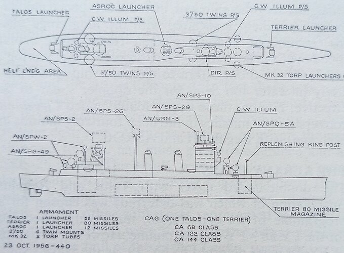

During the early design studies for what would become the Albany class guided-missile cruiser conversions, one of the options explored was for a Mark 10 Terrier GMLS at the fore and a Mark 12 Talos GMLS at the aft:
SOURCE: Friedman, Norman. "The '3-T' Programme." Warship, edited by John Arthur Roberts, Volume VI, Conway Maritime Press, 1982. Retrieved from https://www.secretprojects.co.uk/th...missile-cruiser-conversions.34375/post-618829
As shown in the above image, the design did not include the pair of Mark 9 Tartar GMLS to the port and starboard of the main superstructure which were included in the final design of the Albany class CGs. Ultimately, the Albany class CGs were equipped with twin Mark 12 Talos GMLS at the fore and aft.

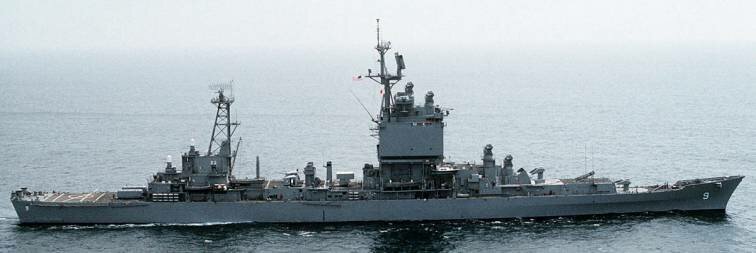

It can also be assumed that the aft Mark 12 Talos GMLS would have been replaced with a pair of Mark 143 Armored Box Launchers for a total of eight Tomahawk cruise missiles as was done with the USS Long Beach (CGN-9):
