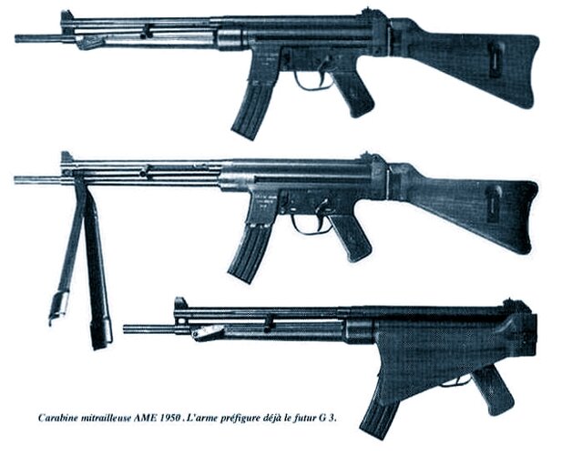

Well the model I would choose remained at the Loeffler and Vorgrimler AME 1950 prototype stage which France had abandoned for budgetary reasons at the time but which had great success afterwards and even evolved into a world famous weapon by the way by Spain CETME and returned to Germany with Hk.

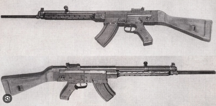

Vorgrimer his model was not accepted for Further Development so he was associated with the work on the Loeffler model as a co-designer of the weapon which initially is the Loeffler project apparently this second position in the CEAM did not arrange it, then this was the departure for Spain at the CETME.

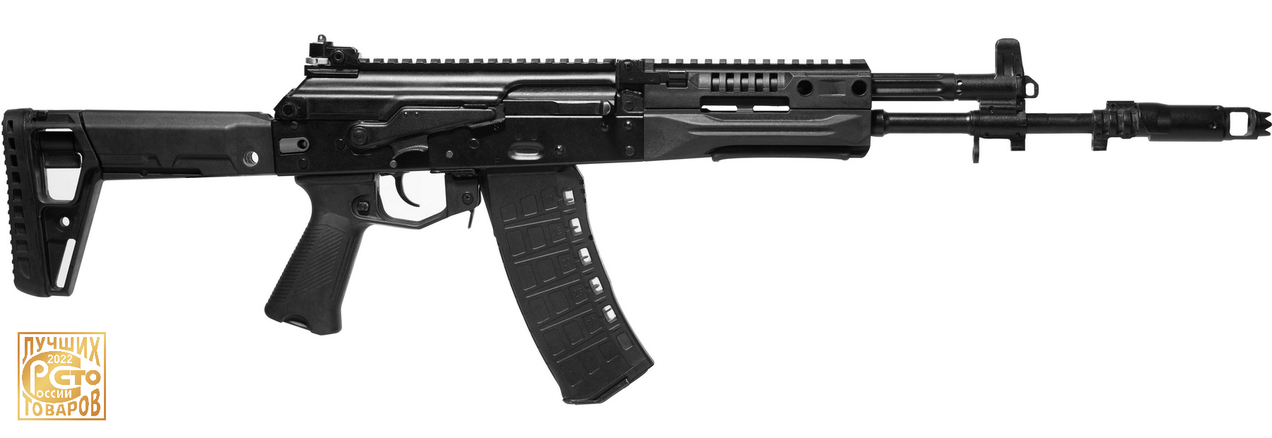

The Russian Ministry of Defense buys the AK-12 for less than $430

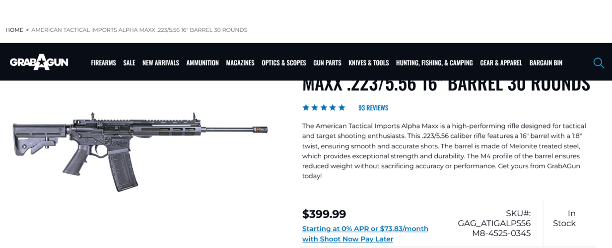

In the case of that ATI rifle, the lower receiver is made from a polymer (albeit steel-reinforced). It also has a carbon-fibre buffer tube, plastic trigger group, etc.
So, the low weight of the Alpha Maxx relies upon substituting for metals. Its appeals will depend upon whether you think plastics/polymers/composites are the future of military small arms.

Surprised that it's low cost with all the materials substituted for metal.
As for the Alpha Maxx, the price and weight have been tailored to a certain sub-set of American civilian shooters. I doubt that any military would ever touch it.
