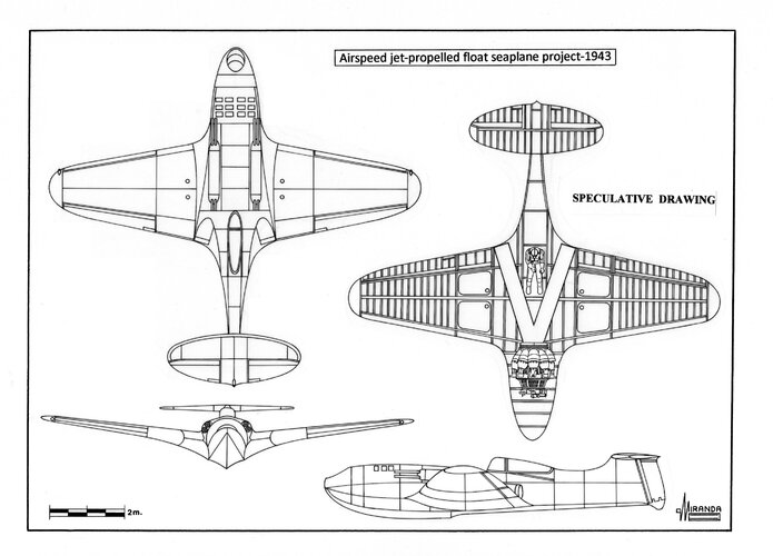

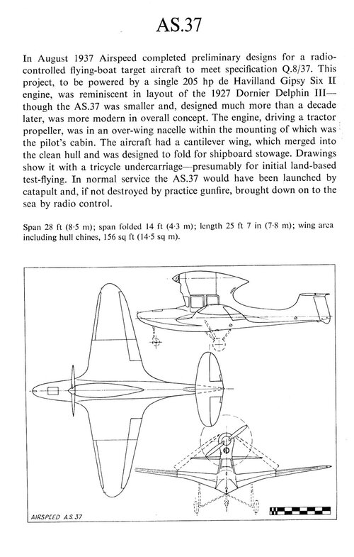

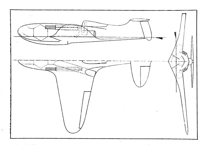

Fighter project, 1943
The Airspeed firm suggested to the Admiralty the transformation of the radio-controlled flying-boat target aircraft AS-37 into a scaled-up jet fighter, powered by one de Havilland Halford H.1 centrifugal-flow turbojet with 1,225 kgf static thrust in the forward area of the hull with the air intake positioned in the extreme nose.
Technical data
Wingspan: 32.5 ft (9.93 m), length: 30 ft (9.14 m), height: 5.9 ft (1.8 m), wing area: 187 sq.ft (17 sq.m), proposed armament: four 4.5 in (11.5 cm) recoilless cannons
Technical data
