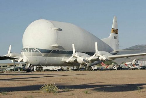

Ask Airbus, given they're the only folk who've dared to hack a 'regular' design-- The A300 into the amazing Beluga...
I'd actually argue that Boeing (with the P-8), Lockheed (P-3), and HS/BAe (Nimrod) have come closer to an airliner/bomber conversion than Airbus ever has.

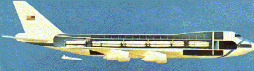

Of course Stealth is not even part of this discussion, as if we are really talking about a cruise missile carrier, and there was a 747 design in the 1980s that was considered as a strategic and naval weapon.
http://www.g2mil.com/bm747.htm

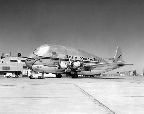

And they got the idea for this 'hack' where?

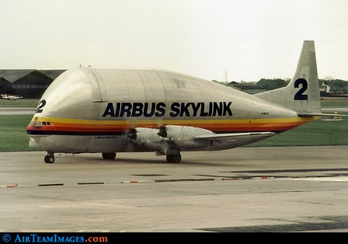

From there (Airbus Industries was using 4 Super Guppy):

Actually this sounds like quite a weapon according to the link.
Just a dozen of these cruise missile armed 747s, armed with over a thousand cruise missiles costing less than one surface escort, would decimate any surface battle group.
And that is only one application.
And the aircraft, pilots mechanics and parts are all available and very (relatively) inexpensive.
I wonder why we have not done this?
