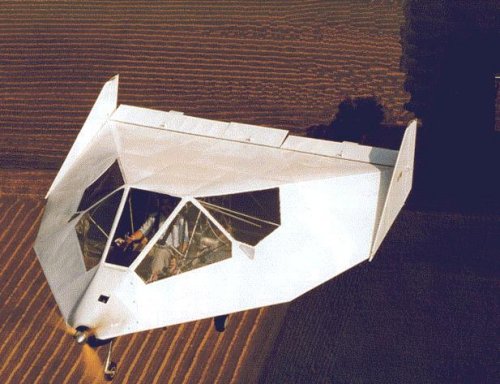

not saucer-shaped, more like Lifting-body.
index.php
if they are build...
