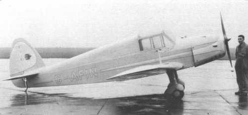

In "The Aeroplane That Flies Itself," a recent article in The Aviation Historian (Issue no. 8, July 15, 2014), Richard Riding recounted the history of Chrislea Aircraft, starting with the Chrislea LC.1 Airguard designed specifically to provide a light aircraft for the CAG. It was not a success and only one was built (photo attached).

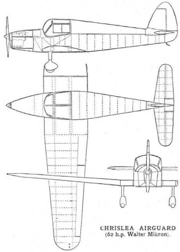

In the same article, Richard Riding says this about the high-wing Chrislea C.H.3 Series 1 Ace. "At first glance, the Ace bore an uncanny resemblance to the pre-war, two-seat Peterborough Guardian. Intended as a contender for the CAG market, the Guardian was equipped with a tricycle undercarriage and powered by a 90 h.p. Blackburn Cirrus. Allotted the registration G-AFZT, it was nearing completion when war put a halt to the project."
Can anyone provide any more information about the mysterious Peterborough Guardian? How about any other designs inspired by the short-lived Civil Air Guard?

Matthew: There's a feature article on the Peterborough Guardian in Flight, 25 Dec 1941, which includes photos of G1 without its fabric covering, some detail drawings, and the attached 3-view drawing (which I've cleaned up a little).
http://www.flightglobal.com/pdfarchive/view/1941/1941%20-%203091.html
http://www.flightglobal.com/pdfarchive/view/1941/1941%20-%203092.html
Air History has the following: Peterborough Guardian, c/n G1, G-AFZT, Peterborough Aircraft Co Ltd/Horsey Toll, 12.10.39, Not completed
http://www.airhistory.org.uk/gy/reg_G-A11.html

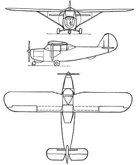

A 15 Sept 1938 Flight feature article on the 'Chrislea Monoplane':
http://www.flightglobal.com/pdfarchive/view/1938/1938%20-%202597.html

Thanks very much, Apophenia, I did actually spend some time looking for the Guardian inmth FLIGHT archives but only up to 1939 or 1940, figuring that there wouldn't be much light plane coverage during the war years. Clearly, I figured wrong.
While seemingly a little narrow for a side-by-side two-seater, the Guardian does have a remarkable modern look about it for the time. Great stuff, thanks.
