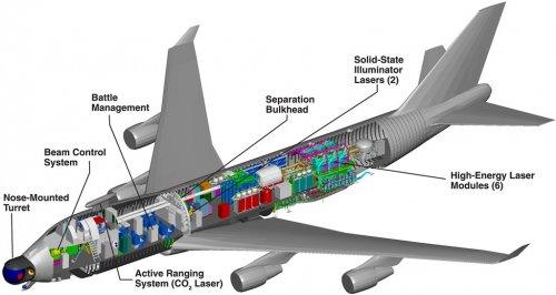

Your question is a little confusing. Do you mean commercial aircraft that are equipped to shoot down other aircraft or shoot down ballistic missiles?
If yes, then there are a number of experimental examples. The most notable example is the US Air Force's Airborne Laser program, which uses a heavily modified 747. Two aircraft were built, but the program will not lead to an operational aircraft.
The US also had a 757 that was equipped with a laser and used for experiments in the 1980s. I believe it also had a DC-10 equipped for the same purposes.

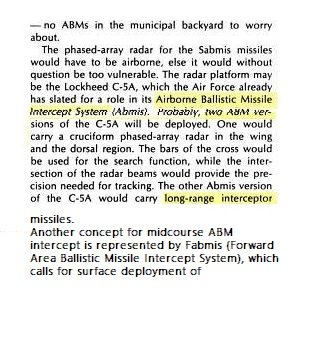

From a document I posted in the Bar on Strategic Weapons in a 1960's memo from SecDef to POTUS:
Disapproving Contract Definition for the Airborne Missile Intercept System (ABMIS), a concept for which there is no advanced development program.
Yesterday I was reading the SABMIS thread and did some further research. I found ABMIS and also FABMIS - quite inevitably, the Air Force and Army own takes at SABMIS.
that is - Nike-X on mobile platforms that can be brought closer from the North Pole to cripple an incoming (small) wave of Soviets or PRC ICBMs.
Also Minuteman I turned ABM to protect their Minuteman III siblings. The whole thing called (no kidding !) Minutemaid, like the orange juice brand. Must be the same idiot that 20 years later come with the name Midgetman for the smaller MX.
ABMIS was to use C-5A Galaxy - some with phased arrays mounted on the wings and fuselage, in a ++ shape; others carrying interceptors.
It amazing, how the Air Force couldn't stop competing with all the other agencies. USN come with Polaris ? Skybolt. USN come wth SABMIS ? ABMIS then. ARPA & Army picks Nike-X ground based interceptors from Project Defender, to Safeguard and Sentinel ? USAF bets all hopes on spaceborne BAMBI, the ancestor of Brilliant Pebbles and Smart Rocks. The CIA starts CORONA ? USAF build SAMOS. And makes the film return capsule big enough, to compete with NASA Mercury. Just in case Dynasoar wasn't enough to get dominance of early manned spaceflight.
