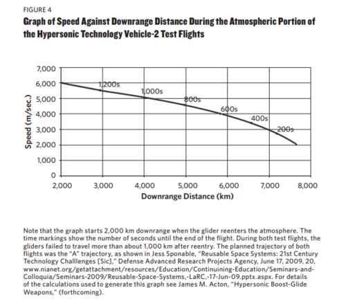

I think there is no issue in using a scramjet missile in air to air role, but I am curius about boost glider so I did some maths
Hypersonic missile are very hot, so I assume detect them with IRST from 400 km is plausible
A hypersonic glider at Mach 20 can fly 400 km in 59 second, in the same amount of time, an aircraft at Mach 1.2 can move 24 km from the origional position.
Do we have the turn rate of any hypersonic glider?
What if the aircraft maneuvers to avoid the missile? The missile would have a large turn radius to re-intercept and burn a lot of fuel. There's also the thought of air friction on the internal components when performing maneuvers, things get really hot when they travel hypersonic.
Boost glider have no fuel to burn, it decelerate gradually
So one opportunity to engage the target? Sounds like an awfully expensive interceptor.
All current long range surface to air missile and air to air missile are like that except ramjet missile like Meteor, you only have once chance to hit the target, if you miss then you miss, there is no re engage like in movie
