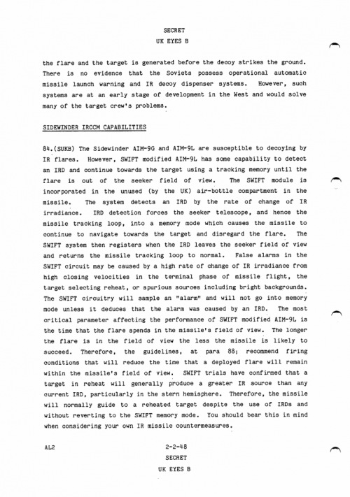

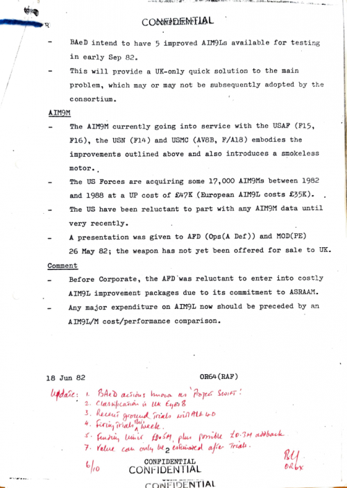

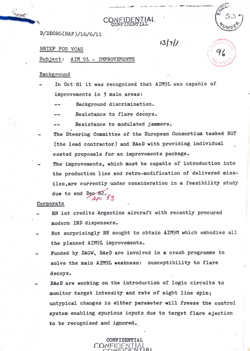

I've been doing more research over the last year and have found references to the AIM-9L SWIFT in a few RAF documents, including one training manual which confirmed what the name means (unfortunately the section about it was redacted):
Sidewinder Improvement against Flare Threat (SWIFT)
So it seems that it was used to some extent by the RAF. Unfortunately I've still not found any information about how the SWIFT came to be or what its capabilities were.

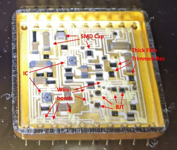

Any idea as to how the flare detection and suppression circuitry worked? Given how long ago it was it was almost certainly analogue and used Op-Amp ICs.

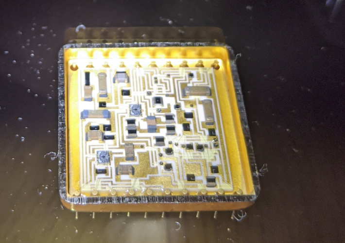

SWIFT wasn't installed until '85 in the FI, which afaik was the first and nobody who mattered, literally nobody, knew they were being delivered. The module filled up 9L argon bottle cavity which wasn't used in the RAF, it was delivered as part of the G&C as a whole unit.
Scott's right in that it sampled the heat source and anything spiking was ignored. The PPRune thread is mainly rumour and gossip, some good stuff. The RAF 'had' 9Ls in 82 but everything we had was dedicated to SACEUR, NATO stock. The US supplied us directly from their own stocks. As the referenced thread says, most shots were rear aspect and 9G could have handled them but the biggest win IMO was that they'd had minimal handling being new. Bad handling such as lifting by the wings could damage the rocket motor
