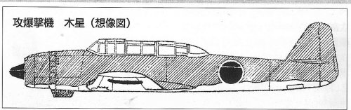

Not unfound. According to another topic, this is the Aichi AM-26 project, also known as the B8A1 Mokusei.
LAW - thanks!
Stargazer, I thought the B8A was supposed to be smaller than the B7A and single seat? That aircraft looks to have a large 'greenhouse' for a crew of more than one?

Hard to find Cherry,
but that's its drawing;
http://www.secretprojects.co.uk/forum/index.php/topic,6691.15.html
Yes it is hard to find, aswell as some information, do you have another image?
Cheers, Cherry
Hi, the name written on the drawing is actually Mokusei (木星), not "Mokusai".
Adrien
Having a better look at the drawing posted on page 1, it is captioned as an "imaginary drawing" (想像図).
