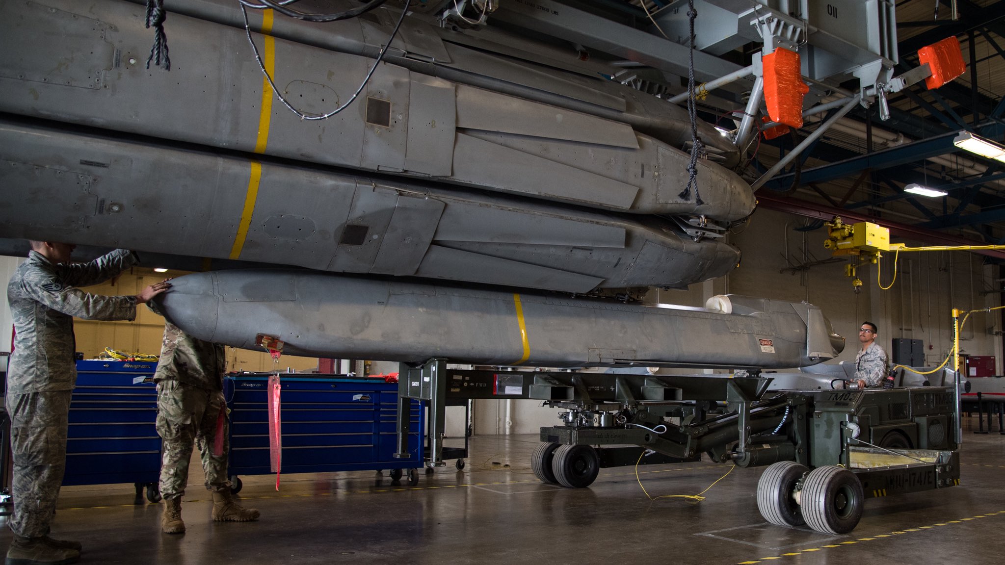

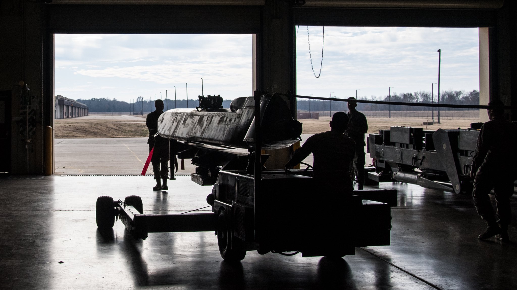

A staple of the Air Force's long-range strike portfolio has come to the end of the road. The AGM-86C/D Conventional Air-Launched Cruise Missile (CALCM), the non-nuclear sibling of the AGB-86B that remains in service as the backbone of the B-52's nuclear strike mission, is being put rest after decades of service. The last download of these missiles from a B-52H occurred at Barksdale AFB on November 20th, 2019, marking the final end to the weapon's service.

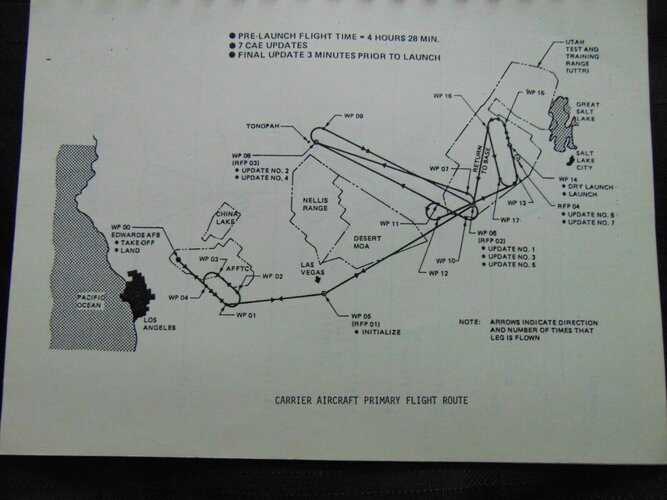

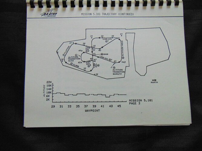

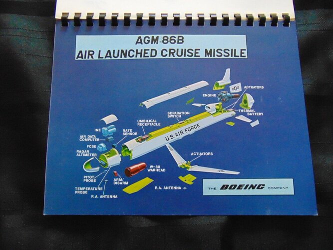

Question on AGM-86. Missile threat states a 3,000lb warhead, but the whole thing only weighed <4,000lb???
It depends on the variant, but the CALCM warhead was approximately 1000 pounds.
The USAF fact sheet says "3000-lb class" but this is likely giving the warhead equivalence, not weight. Factor in an REF substantially better than 1, improved warhead casing design, smart fuzing, etc. and you get the effect of a notional 3000-lb bomb in a much smaller package.
Warhead is W80, probably like 500 lbs or less. An entire B-61-7 is like 750 lbs. conventional conversions of the ALCM had ~1000lb warheads and reduced range compared to the strategic version.
EDIT: the entire weapon is 3000# class, not the warhead. The JASSM is 2000# class with a 1000# class warhead.

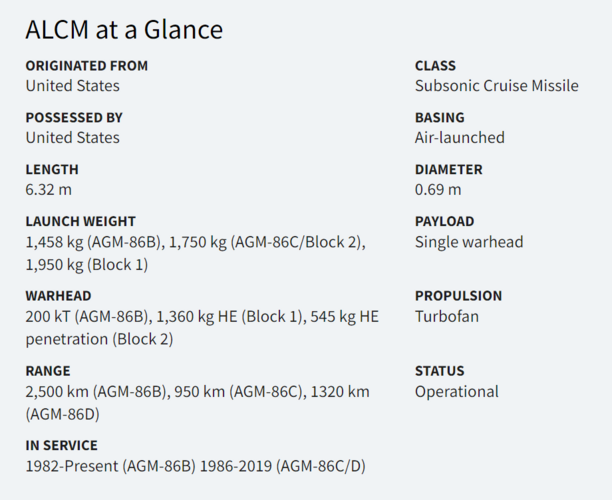

I could not find any mention of "3000lb warhead" in the link you provided .....
Anyway, your question has been answered (correctly) by all the posts above mine .....
1,360kg (AGM-86C Block 1).
Also echoed here and on wiki.

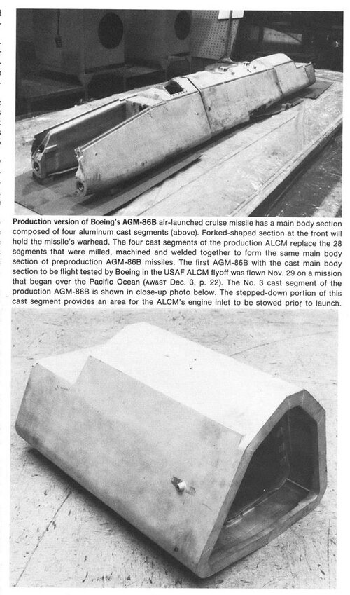

Ah, this helps, noting that the launch weight for the C models is significantly higher than for the nuke version.
I was not expecting that much to be big cast chunks.
I never really thought about it but if you'd asked me how the AGM-86's fuselage was constructed before I read this thread I would've said it was a riveted semi-monocoque structure aka "Stressed Skin".
That's exactly what I was expecting. Stressed skin with a couple big longerons to carry the warhead and mount on the pylons.
