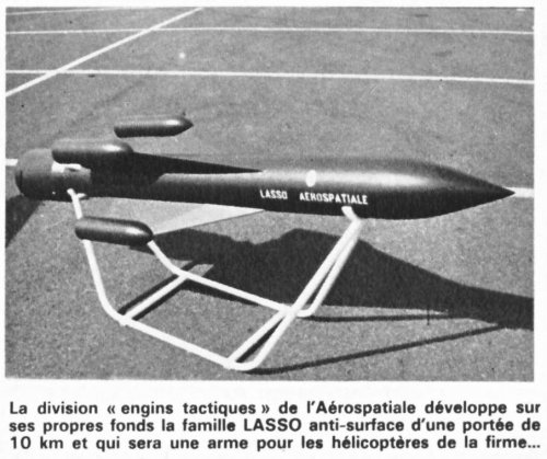

This is the second time I've come across the AM.10 in my reading. Does any one have any more information regarding this interesting missile? I've never seen an image of this missile, though it sounds based on the earlier AS.12
From Aviation International N°732, 15-30 June 1978

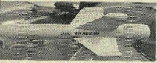

Interesting, cardonet! I found another shot in the Flight pdf archive dated May 1978.
It seems that mockups were presented at several exhibitions but I am not sure this missile was flight tested.
I did not find it mentionned in
http://www.chear.defense.gouv.fr/fr/pdef/histoire/missiles_tactiques_comaero.pdf
