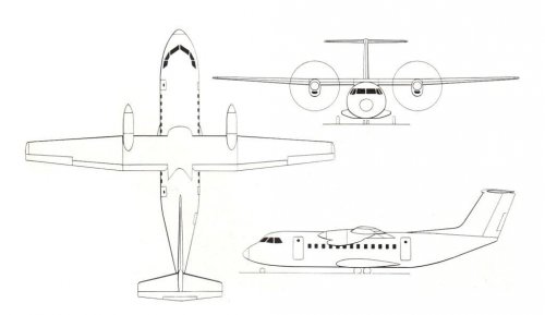

An Italian project for passenger and cargo duties:
Aeritalia AIT 230
Aviation Magazine Num 768 (15-XII-79)
First Flight was expected about 1983 and it could be ready for deliveries by 1985.
Aeritalia wanted to partner with an US manufacturer to ensure its introduction in the American market. An stretched version (50-60 passenger) was also studied to be launched after the 30 passenger version.
Engine: turboprop PT6A-65
Lenght: 16.35 m
Span: 21.26 m
Empty weight: about 5500 Kg
Max weight: 9367 Kg
Cruise speed: 386 Km/h

The Aeritalia AIT-230 (or maybe AIT230) was the Italian precursor of the ATR 42 (along with its erstwhile competitor, Aérospatiale's AS.35).
Flight describes the AIT-230 as "a high-wing aircraft with a four-abreast cabin layout" ... "powered by two P&W PT6A-65s".
Does anybody have any images of or other details on the AIT-230 project? Thanks in advance.

I just found pometablava's 28 Nov 2006 post with an AIT-230 3-view and data (for some reason that didn't turn up in a site search).
http://www.secretprojects.co.uk/forum/index.php/topic,872.15.html
More than an ancestor of ATR it looks like a civil version of the G-222.

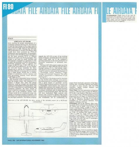

Dear Boys and Girls here is an article about an early version of the Aeritalia AIT-230 turboprop airliner "project" which later led to the Franco-Italian collaborative ATR-42 airliner......
The article comes from the March 1980 issue of Air International......
Terry (Caravellarella)
  • Aeritalia AIT-230-208 project 3-view drawing - Air International - March 1980.......jpg

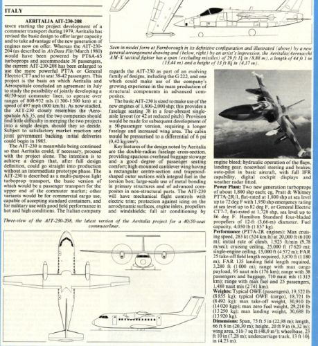

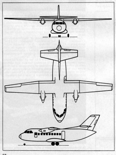

Re: Aeritalia AIT-230-208 turboprop airliner project......
Dear Boys and Girls here is an article about another, later version of the Aeritalia AIT-230 turboprop airliner "project" which led to the Franco-Italian collaborative ATR-42 airliner......
The article comes from the November 1980 issue of Air International......
  • Aeritalia AIT-230-208 project - Air International - November 1980.......jpg
  • Aeritalia AIT-230-208 project 3-view drawing - Air International - November 1980.......jpg

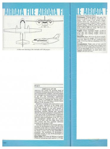

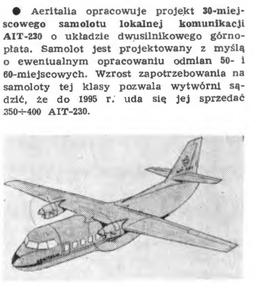

a little info about AIT-230-204 version.

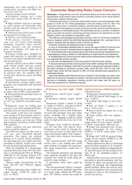

1979 AWST article
