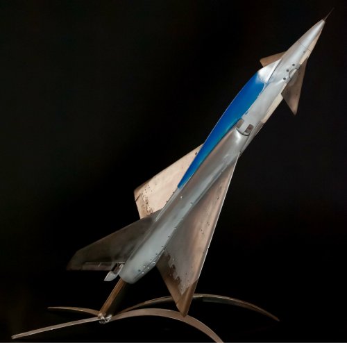

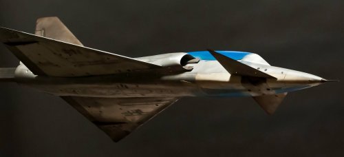

Did someone say Crescent wing?
When I red Tony Butler books 15 years ago, I really liked the type 545. A crying shame it never flew. Thanks for the drawings.
And D'OH for tailed deltas, forgot those ones.
Yeap it bang on the button for the general trend of the times. A host of aircraft of the period have compound sweep back and it does deliver more benign characteristics.
Always liked the 545.
So TA's effort would be like that only with twin engines and a bigger radome.
So how radical is the radical canard?

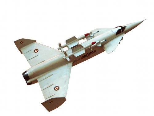

I was thinking either like the vicker Supermarine offering or something like unmanned drones based on the Avro 730, which I can't remember the designation of.
