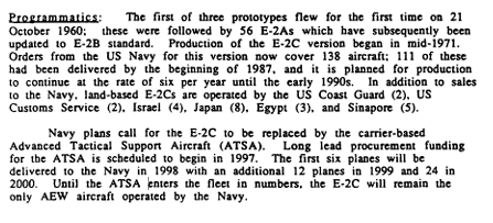

I hope someone has more, renders, more info on these multi band array antennas that sound very novel for the time.

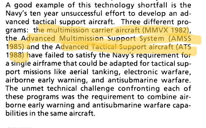

There was a zoo of programs. In your searches note that ATS often being used without _A
So that's three programs that we have very little on. One on a couple of Grumman designs for MMVX, one on a possible Northrop design for AMSS with a couple posts on Lockheed or Grumman or a collaboration of the two on another AMSS design, and this thread. That isn't a lot for three programs that were obviously a Navy priority, and they were followed by CSA which was similarly unsuccessful, though I thought that was more a matter of post cold war procurement malaise.
Speaking to the attachment above in post 5, both ASW and AEW require long loiter times and high endurance, but one involves low altitude search at slow speeds and the other high altitude loiter at longest endurace cruising speed. That isn't as big a challenge as combining the F6D and F-111 in one aircraft, but is it really so big a challenge that no one in the 80s could manage a solution and come up with a aircraft to satisfy the Navy?

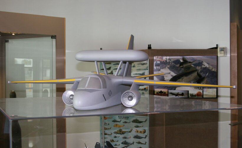

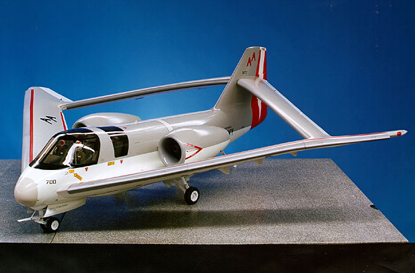

It's a beautiful model!!
Regards
Pioneer
Regards
Pioneer
I just have serious reservations over the placement of the engines... the aircraft attitude while landing will be slightly nose-high... meaning that disturbed air from the wing will be entering the intakes - as well as the wing partially blanking the intakes right when it is absolutely critical to have max power available instantly.
