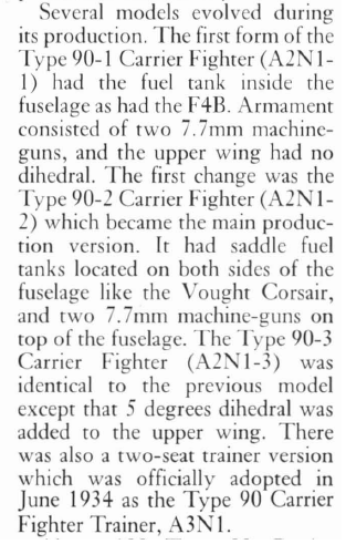

It was a two-seat carrier fighter,from Japanese Aircraft 1910-1941

I can't find the source of this wikipedia information. I can't find the aircraft named Mitsubishi A3M1.
According to ENCYCLOPEDIA OF JAPANESE AIRCRAFT VOL.5 NAKAJIMA AIRCRAFT CONTENTS and VOL.1 MITSUBISHI AIRCRAFT CONTENTS,
A1N1~2 : Nakajima, The Navy Type 3 Carrier Fighter
A2N1-1~-3 : Nakajima, The Navy Type 90 Carrier Fighter
A3N1 : Nakajima, The Navy Type 90 Carrier Trainer Fighter
A4N1 : Nakajima, The Navy Type 95 Carrier Fighter
A5M1~4 : Mitsubishi, The Navy Type 96 Carrier Fighter
A6M1 : Mitsubishi, The Experimental 12-shi Carrier Fighter
A6M2~8 : Mitsubishi, The Navy Type Zero Carrier Fighter
A7M1~2 : Mitsubishi, The Experimental 17-shi Reppu Carrier Fighter

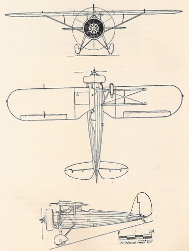

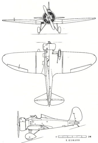

Candidates for 7-shi carrier fighter.
The Japanese Imperial Navy rejected these planes.
So I think that Nakajima and Mitsubishi did not hope to call these aircraft as A3, then the IJN decided to call A2N1-3 trainer version as A3N1.
