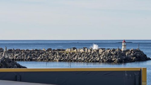

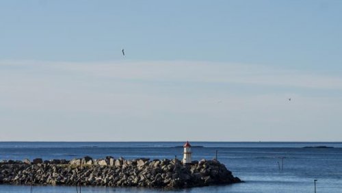

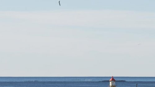

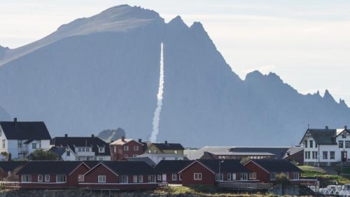

Unfortunately, not good news:
Australia's SCRAMSPACE hypersonic flight experiment from the Andøya Rocket Range in Norway has been discontinued, following an unsuccessful launch.
The team can confirm the launch took place and both the first and the second stages of the launch have landed safely in the water.
However it appears at this stage that the payload did not reach the correct conditions to begin collecting data as planned.
