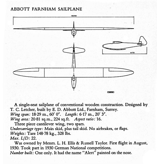

Hi All.
Looking for any drawings of sailpane designed by T. C. Letcher and built in 1930 by E.D. Abbot company called "Abbott Farnham sailplane" or Alert (as it was marked on nose). No problem to find some info, but drawings are different story.

I found this drawing in 'British Gliders & Sailplanes', page 72.

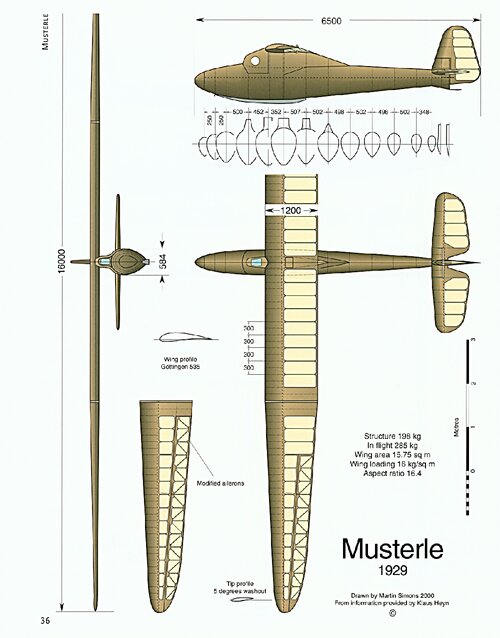

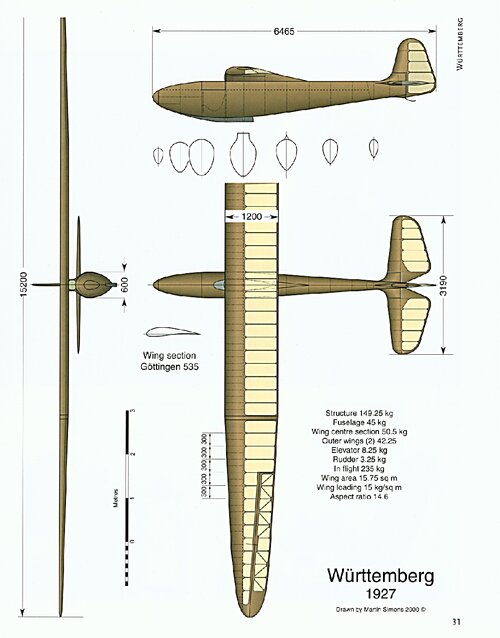

I don't think it's particularly accurate, but looking at the photo's you've posted, the 'Alert' looks to follow the 'Darmstadt School' of design, it's very similar, to my eyes at least, to the 1927 'Wurttemburg', and also the 1929 'Musterle'.
See 'Sailplanes 1920-1945', Martin Simons, pp. 30 - 37.

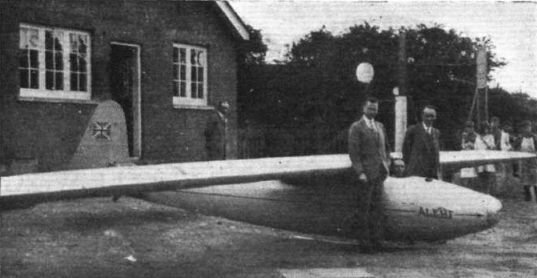

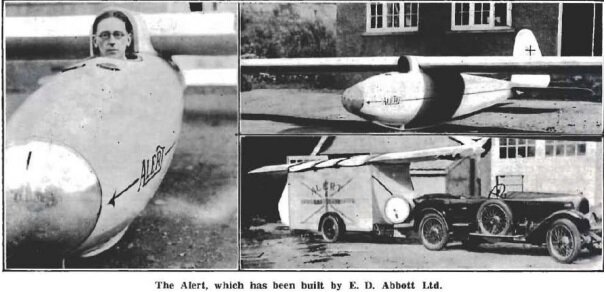

Only inaccuracy in the text description from British Gliders & Sailplanes', is that the Alert took part in the German competition in 1930. It was supposed to, but according to 'The Sailplane' Sept 6 1930 edition; 'There was great disappointment that the two British entries failed to arrive. These were the Alert, an interesting new sailplane which has been built by E. D. Abbott Ltd. of Farnham, and a Professor, which was to have been flown by a member of the London Gliding Club.'
View attachment 697536View attachment 697537
cheers,
Robin.
Robin,
I think the overall layout is closer to the Westpreussen series, even more so since one of them was the ill-fated "Cloudyacht" purchased by the Lyons Tea company and I'm pretty sure the designer must have taken a nice, close-up look to it. Still, Laubenthal's designs bore a resemblance to the Darmstadts.

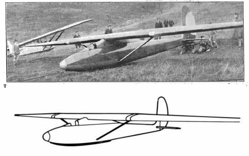

Yes, a tracing of the sailplane on the ground. Plenty of references to the project in The Sailplane and Glider but never with a 3-view. Pity as Dickson was an interesting character with several good-looking designs to his credit. Phantom 8.jpg
