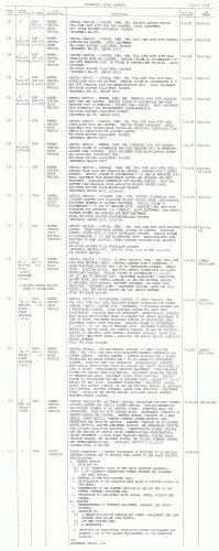

...Do we have a breakdown chart as to which production Mercury spacecraft were assigned which model numbers?
OM said:
while Mercury was Model 133K through 133N
It's all in there (check the McDonnell model list topic in the "Designation Systems" section).
Anyway, I've compiled the whole Model 133 sections into one single file for you (see attachment). You'll notice that the variants didn't carry a name until 133K (first MERCURY) and also that later developments of GEMINI such as GEMINI "B" (Model 195B) or BIG GEMINI a.k.a. "BIG G" (Model 208) are not included here.
...Outstanding work, sir! Might be wise to add some of this data where applicable to the Wikipedia and EA entries. The latter shouldn't be a problem, as Mark Wade's pretty good about adding corrections. Wikipedia's the problem, as there are too many C-word-A-Couple-of-Trolls-take-offense-to acting as admins who'll revert the additions simply because they weren't the ones to add them.
