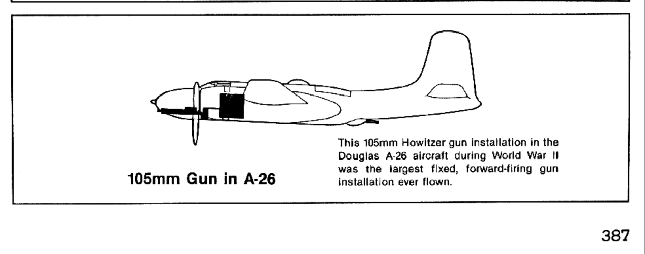

I found this in Chinn's "Machine Guns" book (vol.V, p.387). I know that 37 mm and 75 mm guns were tested on A-26, but first time I see 105 mm howitzer. Maybe someone have more information about this project?

What kind of howitzer this was supposed to be?
AFAIK There seems to have been at least two candidates: 105mm T12 aircraft howitzer and 105mm T9E2 autoloading recoilless howitzer.
This is probably a fantasy design or at best a sketch by someone no overly familiar with the A-26 layout.
There is no record of any aircraft in WW2, other than the Piaggo P-108 having flown with an gun larger 75mm, not even an experimental aircraft. the USAAF/USAF consistently state the 75mm* was the biggest gun carried up until the AC-130 which did have a 105mm howitzer. There does not appear to be any verifyable evidence that Douglas even considered a weapon on this size for the A-26, I have found no mentions in numerous books including McDonnell Douglas Aircraft since 1920 (Francillon).
(*This does not count recoilless weapons or experimental rocket guns such as were trialed on the B-25 in WW2)
Also a quick look at the image provided, the 105mm appears to occupy much of the space used for the forward landing gear. Even the smaller 75mm had to be placed higher up to get enough space in the nose. The position look very much like the B-25G/H models so I would suggest that someone has done a bit of "wishfull' drawings without consideration the the A-26's actual layout. Even one of the "light" model of a 105mm weapon were much wider than the 75mm weapons so I doubt that one would have fitted into the slim A-26 nose at all (unless you accepted a fixed nose wheel).
You might be looking at a recoilless 105mm. There were two US Army Ordnance designs at the time.
I very much doubt that it would be recoilless. Such guns generate a huge blast from the back end and there seems to be nowhere it could go in that sketch except into the fuselage - which would result in its immediate demolition.
The sketch is just that...sketchy without detail. It would be a simple matter to vent waste gas from the recoilless rifle out into the air stream.

It may be possible but it wouldn't be simple - what comes out of the back of a 105mm recoilless gun isn't "waste gas" - it's effectively a large and violent explosion, as about 80% of the propellant gas vents to the rear at supersonic velocity, capable of causing structural damage not just lethal injury. When such guns are fired on the ground, there is a very considerable fan-shaped safety zone left behind the gun.

The A-26 was suppposed to be (or they tried to make it into) the answer to every need from ground attack up through night fighter and medium bomber. In many ways this was true, but the USAAF did go a bit crazy, falling into the "if we can build it then it SHOULD be built" mind set.
The 105mm was no exception to the above. I have drawings, photos and documents of the 105mm aircraft-mounted cannon that was designed and built by Oldsmobile. It is late and memory fails, but if I recall correctly I don't think it was ever tested before the war ended.
But let us not stop here. The USAAF actually wanted to test 155mm guns in aircraft. I have a few documents that discuss this, but I don't think anyone was ever actually crazy enough to try to even design one much less build it.
Hope this helps.
AlanG
Excellent! Can you please confirm the nature of the gun (i.e. army howitzer or something more exotic) and also whether it was manually loaded or there was some kind of autoloader?
Interesting. Would this be related to "Notes on the 105 mm Gun Aircraft Mount T17", Rock Island Ordnance Center, 1944?
Another question might be: Did GM's Oldsmobile Division have any involvement in the AN-M9 mount for the 75mm AN-M5?
With respect, the 75mm easily occupied the space in the cockpit that the navigator normally occupied. A 105mm would have reasonably fit as well, especially if the gun was offset in the nose the same way the 75mm was. Also, given the author of the book, I would be very reluctant to classify this as a "fantasy drawing" or simply wishful thinking. The author of the book in question was, at the time, Americas foremost weapons expert and a USMC Colonel. If anyone would know about the use of weapons during and after WWII, itd be him. Thatd be the equivalent of finding something Bill Gates wrote about how software works and calling it fantasy.
From The Machine Gun Volume V by Col George M. Chinn, the hyperlink has the full PDF of Volume V.
Chapter 44, page 387 related to MCDouglas Helicopter Company weapons development (formerly Hughes Helicopter?)
