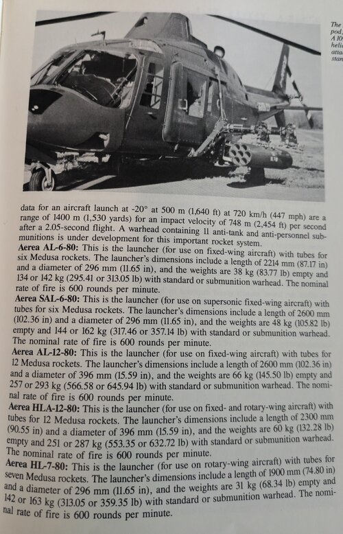

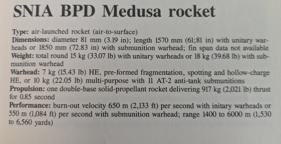

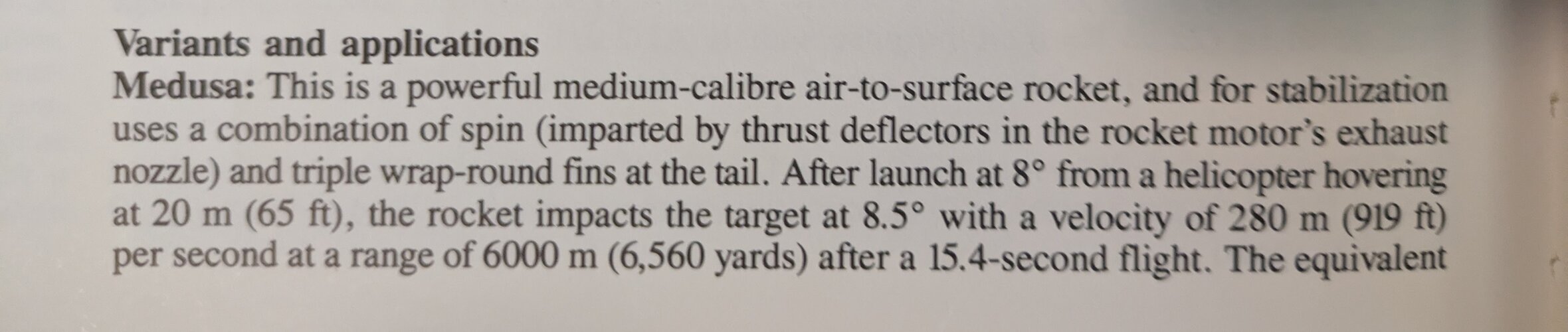

Christopher Chant's Modern Air Weapons (1988) has an entry for Medusa as a SNIA BDP product sandwiched between their 51mm and 122mm offerings. The entry for SNORA in the same book mentions that it was jointly developed with SNIA BPD and Oerlikon, so it's a fair bet that these are the same basic rocket.
The entry for Medusa talks about an in-development submunition warhead weighing 10 kg with 11 AT-2 anti-tank submunitions. But this AT-2 must not be the German one, since that was >100mm in diameter and >2.2 kg.
I happen to also have a copy of Jane's Air Launched Weapons that draws a distinction between the original SNIA BPD 81mm rocket and Medusa, which included the electronic management system as well as the rockets themselves. Around 1990, Medusa was reported in production, but no user details ever emerged and I'd guess it was dropped fairly quickly.

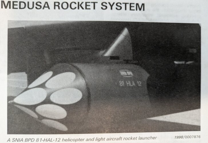

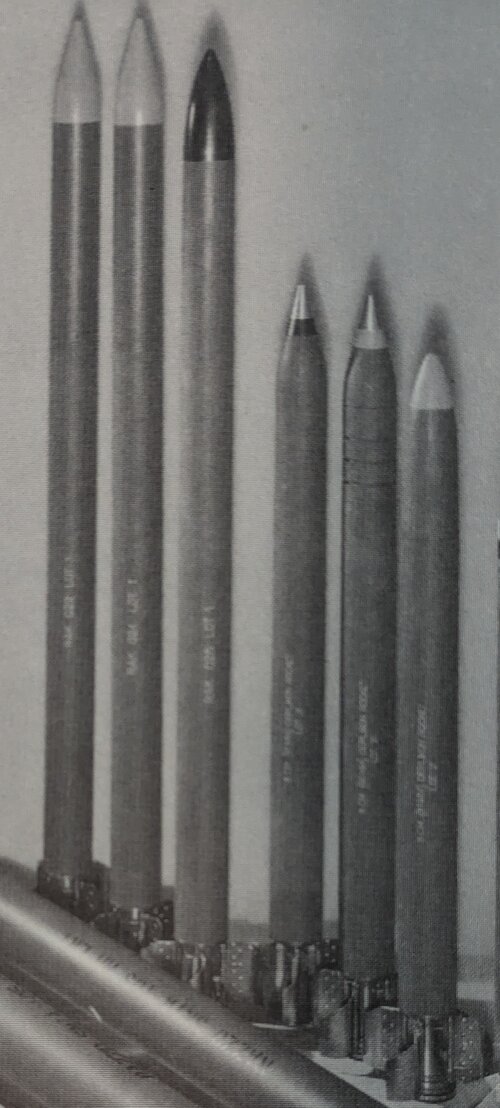

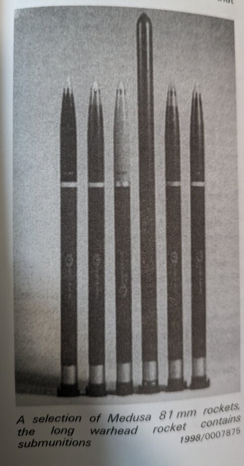

Two images from that Jane's article.
The long submunition warhead had two options -- an anti-tank bomblet and an anti-personnel/anti-materiel bomblet. In each case, there were 11 submunitions in each rocket. (Hydra 70 had a similar submunition warhead, the M261.)
One note about caliber: this was definitely an 81mm rocket. The confusion may stem from the fact that Aerea made a series of launchers for it with the number 80 in their product names. Not sure why, but this also happened with Aerea's 51mm rocket launchers, which were designated with 50 rather than 51. Note that the actual SNIA launcher shown here was 81 HLA 12 (81mm, helicopter and light aircraft, 12 rounds)

From IDR 2/ 1989:
Medusa differs from Snora in a number of ways. In response to an Italian Army requirement, SNIA BPD initially sought to improve the Snora warheads effectiveness on the target. Subsequently, aerodynamic improvements were made: the number of fins was reduced from four to three and their aspect ratio increased. In addition, the conic shape of the Snora warhead was replaced with a more streamlined one. All this enabled the maximum range to be extended from ten to 12km. SNIA BPD also found a way of increasing the mass of the explosive charge, which now fills not only the cylindrical part of the warhead as in Snora, but a large part of the nose cone as well.

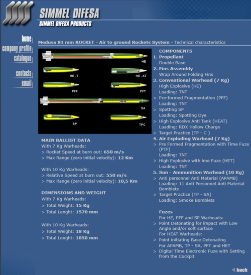

The IDR article and a bunch of other stuff on Medusa can be found in this warthunder forum thread that for some reason does not show up in google searches.
