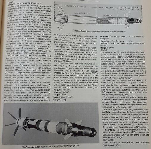

Since guided 5in shells, especially Deadeye, have come up in a couple of naval topics recently, here is a description from Jane's Weapon Systems.
Development seemed to be progressing well before it was cancelled due to budget cutbacks.
Interestingly it looks like there were plans to scale up Deadeye for 8in and 16in rounds which must have been linked to Iowa and potential Des Moines-class reactivations.

8" was also for the Mk71 gun, that could be refitted onto any Sprucan or Tico. Or anything else with a 5" Mk42 turret spot.

Mark 71 was pretty much dead by the time Deadeye got started. There were proposed semi-active laser homing projectiles for it, AFAIK, but as a separate programme.
The original 8-inch SALGP appears to have been called Paveway (from when PAVEWAY was a general term for laser guidance, not specific to the air-dropped LGB.)
The 8-inch Mk 71 did attempt a brief comeback in the 1980s, around the same time as the battleships. There's an ad from that era in the Mk 71 thread, I think.
Aside: the Mk 71 won't fit everywhere a Mk 45 will. It's deeper by about a full deck and so could not fit in the aft position on the Spruances, for example. And I think it would have displaced some forward VLS cells in the DDG-51 in a proposed retrofit there as well.
