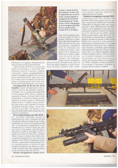

According to McNab (2012), the Stabilimento Militare Armi Leggere Terni or SMALT had produced a conversion kit to adapt the MG 42/59 GPMG (Italy's license-produced version of the MG 42 / MG 3) to 5.56×45mm NATO ammunition (p. 25). Uncited entries on Wikipedia claimed that the conversion kit consists of a new barrel, bolt head, feed opening and cover, recoil-enhancing element, and a lighter bolt. It is also claimed that the weight of the modified 5.56×45mm MG 42/59 GPMG remains unchanged from the original version.
SOURCE: McNab, C. (2012). MG 34 and MG 42 Machine Guns. Osprey Publishing.
An online search on Google has yielded little to no information on such a conversion kit for the MG 42/59. Does anyone have any information and pictures about this conversion kit? Did such a conversion kit actually existed?

That SMALT 5.56 MG 42/59 conversion kit did exist. But the Esercito saw no advantage in it. The switch to 5.56 increased the ROF - which was already seen as a problem with the MG 42/59. After faffing about with the troublesome 5.56 mm Beretta AS70 LMG as a potential squad weapon and replacement for the MG 42/59, the Esercito finally alit upon a Beretta-licensed FN Minimi instead.

Even higher ROF and not any lighter for the weapon proper.

CETME AMELI: 11.7lb belt fed 5.56. The Minimi is 17lbs, 50% heavier.
I don't suppose you know any information sources about the SMALT MG 42/59 conversion kit?
