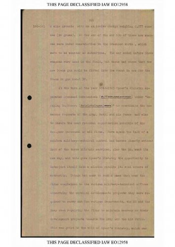

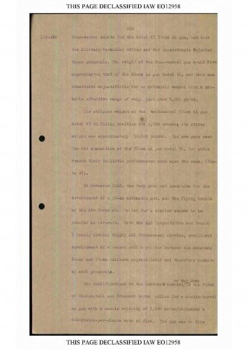

still from DTIC .
1070 ms with a minengeschoss of 330gr . Not very different from a 30x184b .
  • geshutz.pdf

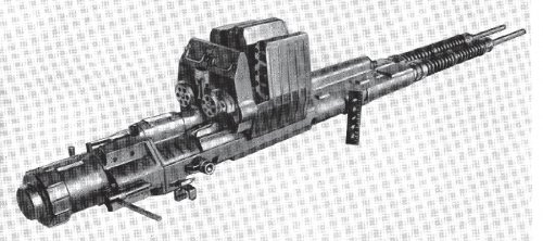

The Flak M44 was developed for the Kriegsmarine by Rheinmetall as a gas-operated machine cannon, using 15 cartridge clips, firing 400 rouns per minute. The only photo I know from it was published by Musgrave.
The name of the gun alone for Czech is 30mm FLAK Model A and B.
I will put the photo later .
Hi Tround,
nice to see that the "Foreign Military Studies" are known! General Renz wrote this work in the 1950`s, and it is quite interesting. I am affraid that the guns cited by Renz aren´t related to Flak M44 but to the MK 303(Br), developed in Brno. To add confusion I know another M44 from Mauser, also intended for the Kriegsmarine. They all fired the same ammo, apparently.
Thank you !
Chinn also add confusion in "the machine gun volume 2" , THe weapon was made by ... Skoda ! ( i think that it's a mistake ) .
I think that M44 is the whole name and MK303 the name of the cannon alone.
Have you more information on the mauser version ?
