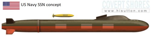

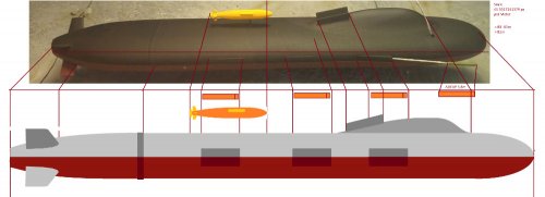

New info on an already obscure project. My guess is it was a design study for a possible alternative to USS Jimmy Carter being modified for Seabed Warfare.
Double hull with external weapons, blended sail and conformal pumpjet casing. Cool design.
Possible twin hull?
http://www.hisutton.com/USN_Submarine_Concept.html

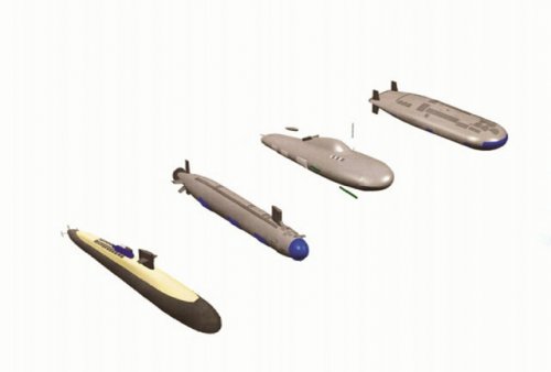

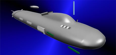

Looks like one of so-called Team 2020 concepts...

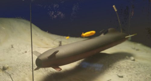

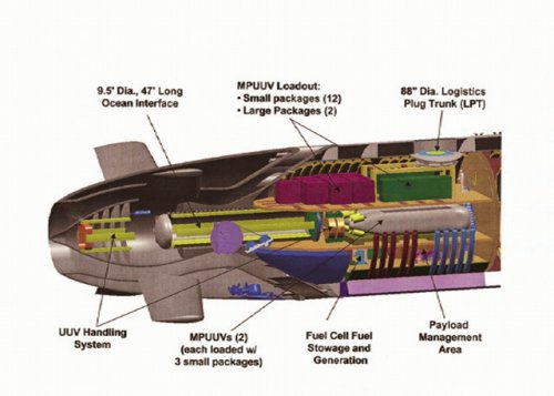

Yeah that's not a dedicated Special Mission sub like 23 is, that's a concept from US Naval Sea Systems Command’s Submarine Future Studies Group for a class of multirole submarines utilizing large UUVs and external weapons. The Forward PASS team ran with a lot of these, including concepts of how to transition from the conventional and affordable Centurion (VIRGINIA) to some really out there configurations over time.
