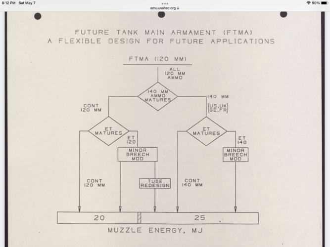

140mm ETC was part of initial plans. One common parameter was a common breech size of 20 cubic liters.

Or we might see a return of female and male (sorry, infantry support and mobile gun) tanks (systems). Well we already see that, but more explicitly I guess. An Puma-esque IFV carrying a 120mm gun with a 10-20 rounds in a bustle loader and like 30,000 rounds of machine gun ammo for three separate .30 cal turret-blisters is probably a more and better tank for actual use in real wars than a M1 Abrams or Leo 2 with a 130mm tbh. Rafael's Carmel is shaping up to be that way, and is even platform agnostic at the end, so it can probably have systems retrofitted to older and less modern vehicles like Merkava IV.
Seriously? The m8 was a prototype, and not a very good one. everybody, including Rheinmetall btw, are still working on it. Its turned out a lot harder to get working in practice then was anticipated, but it has absolutely shown to improve penintration. And tanks stoped useing a larg amount of ammo? Have you heard about desert storm? Because I sertenly remember the reloads that happened then and it would have been hard to pull that off agenst the Soviets. Tanks are always going to use a lot of ammunition even with moder sites, hell we still use a lot of PGM's and there a hell of a lot more accurate then tank shells ever can be.
Honestly the reason it hasn't been done yet is because tank development froze in 1991 only slowly started to thaw in 2014 and is now going to freeze again thanks to the no show of the Armata. China doesn't seem interested in new tank developments so unless indea and Pakistan really want to start there own cold war i suspect the regular old 120mm is going to remain with us until 2100.
ETC so good Rheinmetall isn't making a 130mm gun with twice as much propellant for the MGCS?
Lightning Bolt had a perfectly functional ETC gun. It was just somewhat bulky, but it still worked lol. All of the conclusion information from the Lightning Bolt paper was about reducing the size of the power bank using new technology, namely rapid charging and high discharge capacitors, not that the ETC gun underperformed or that it somehow didn't perform as designed. The point was that theoretical gains of ME for ETC were irrelevant.
What you got, essentially, was a cleaner burn and faster ignition. This doesn't translate to improved muzzle energies; it does translate to slightly better dispersion at range (less time between FCS fire signal and divergence of gun within the fire window) and slightly better performance across ambient temperature extremes (it'll shoot without substantial ME losses in frozen Siberia as well as it does in Iraq).
Conversely the results were so disappointing on the ME front that 130mm gun came back.
Of course, MGCS might be killed due to lack of functional opponents, or maybe Europe will fracture in the coming decades between UK/Poland and France/Germany again and give impetus to make new battle tanks.
Either way the wind blows, future tank guns may use ETC, simply because it provides better ambient temperature burn characteristics and a faster ignition, which can be helpful in extremely long range engagements (>5 km) against tanks; but that implies that tanks will fight other tanks in the future. This is increasingly less likely as in current events, we see that artillery and aviation are still the main killers of main battle tanks.
But using ETC as a replacement for larger caliber tank guns to improve armor penetration is off the table. Now and probably forever.
A) the Thunderbolt deminstrator wasn't perfectly functional i have no idea why you think that.
B) even then it showed improved energy output to the lower end of what a 140mm can do
C) why do you keep talking about the 130mm like it means something? For one they have already moved back to a 140mm for the exact same reasons they worked on it back in the 90's so maby get your facts straight. and second there still working on ect, there working on a regular gun as well because ect isn't ready yet for a bunch of reasons and thanks to the Russian economy exploding again probably isn't going to get the funding to bring it out of the lab until the end of the century.
A) It was functional enough. The main concerns were related to building up and discharging enough energy fast enough, not to the gun itself.
B) Guess 130mm isn't necessary, but then why did "make the gun bigger" come after all these ETC experiments failed? 16 MJ also isn't "low end 140mm". It isn't even in the same ballpark. It's literally a single digit percentage improvement over DM73. Roughly about 8-9%. Turns out all the ME gains of ETC were achieved more or less completely by using slightly hotter propellants in the existing tungsten sabot rounds.
C) The only people bringing out museum pieces like ATAC are the French. Which are now owned by Rheinmetall. I wonder what MGCS will use.
Regardless, if "they've" moved back to 140mm, that sort of proves the point.
