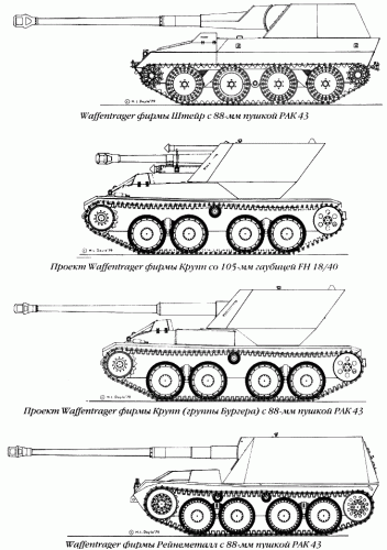

Not on the Pz38(t); however, I've seen 4 designs(2 by Krupp, 2 by Rheinmetall-Borsig) using the Pz38(d) derivative of the Pz38(t). The Pz38(d) is lengthened compared to the Pz38(t).
One of the Krupp designs has a tall, open-backed, open-roofed superstructure mounted on the turret ring(seems to be capable of traverse); the second one has a front-mounted engine, with an open-backed, open-roofed superstructure on the rear that can traverse at least 90° to each side.
The Rheinmetall designs follow the same general lines; one has front-mounted engine with an open-roofed superstructure capable of full traverse, the other has a rear engine with an open-roofed turret on the turret ring.

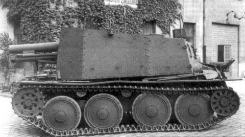

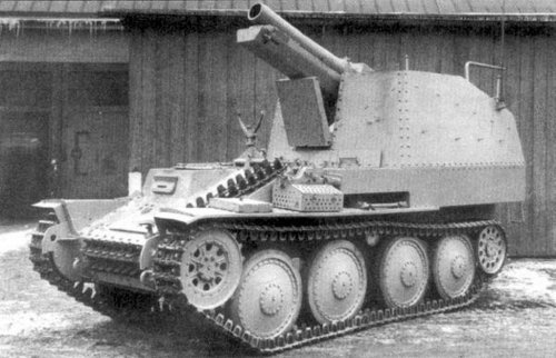

10.5 cm leFH 18 Howitzer on the Pz38(t) Chassis shuold look like this.
panzer1946 said:
those 2 photos show the Sig 33 150 mm mounted, NOT a 105 mm.
He meant that it would have been a similar installation.
there are probably paper-panzer versions of a 105mm being installed, but I don;t think they are 'similar' or 'should look like...' the photos submitted.

here are some paper-panzer samples on 38(d) chassis. the 2nd one for the top is a 105mm version.
That would be the Krupp front-engine design I mentioned on the second post of the thread.
