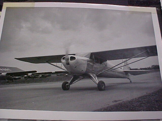

Can you help identify this plane pls? Is this a Helio Courier? From the extra landing gear struts, wing braces, tailwheel and horizontal tailplane I am doubtful. However it has the two side windows and third circular window like a Courier.
I think that's a Cessna 140.
Looks like a Taylorcraft with a custom metalized fuselage.
Closest Taylorcraft that I could match to is the Taylorcraft 20. Some features are similar, undercarriage and horizontal tail, but still not there.
Agreed, not a Cessna 140, because of undercarriage shape, rectangular bracket midway from wingstruts to lower surface of wing - those are Taylorcraft features. Definitely no Helio.
I'm reminded of the prewar Luscombe 8 series - before the cantilever main gear and single wing struts. But this aircraft has too many side windows to be a Luscombe :confused:
I'm pretty sure this photo was taken at the Taylorcraft factory in Alliance Ohio just before they went bankrupt post WWII. This was probably a prototype using aluminum skin instead of fabric for at least the fuselage. The aircraft parked in the background look like Taylorcraft's model BC-12. You can make out the letters RAFT (TAYLORCRAFT) on the roof of the triangle frame hangar which matches pictures of the main factory building in front of the runways at the old Taylorcraft Factory Airfield in the 40's. I have no proof of this just deductive reasoning.
I agree that the mystery airplane has a distinctly Taylorcraft feel about it. And the setting is interesting. But that sure looks like a well-rounded, semi-monocoque fuselage to me. [1]
The more I look at that side door, the more it says 'early Luscombe 8' to me. And then that cowling laughs in my face and screams 'Taylorcraft BC-12'! :D
__________________
[1] The CCF-built Norseman Mk.VII gives a good idea of how an aluminum-skinned tube frame will likely looks.
-- https://norsemanhistory.ca/Photos/CCF-129.jpg
Thankyou my friends for your interest. I am also leaning on the Taylorcraft idea, but I need to see photos of non fabric roundish Taylorcrafts to decide. Cheers
There are Luscombe Silvaire 8As and '8Cs around with quarterlight windows fitted. AFAIK, these glazings were later mods applied after the rear fuselage fuel tank was removed. And those glazings all seem to be roughly triangular, not circular (?) like your mystery aircraft.
I have also seen an image of an early Luscombe with divided door windows ... although I can't trace my way back to that photo :(

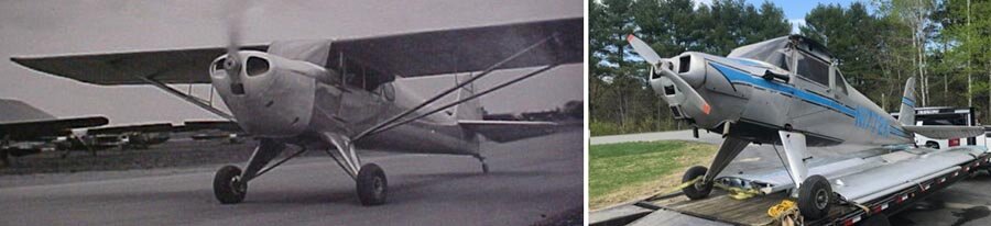

Attached is a rough comparison between your mystery aircraft (tweaked for perspective) and a rear-windowed Luscombe fuselage. A few features jump out at me.
- The mystery aircraft has a better-rounded rear fuselage than the Luscombe; [1]
- The Luscombe elevators have a more rounded inner trailing edge;
- The mystery aircraft seems to have better-faired undercarriage struts; [2]
- The wing strut attachment point is much further aft on the mystery aircraft;
- And then there are those dramatic cowling differences ...
__________________________________
[1] The Luscombe rear fuselage has fairly dramatic faceting between the upper door openings and curved rear fuselage.
[2] The main gear differences are exaggerated here by the stance of the stripped-down Luscombe fuselage.
Yes my mystery plane is very close to the Luscombe 8. Still a mystery though.

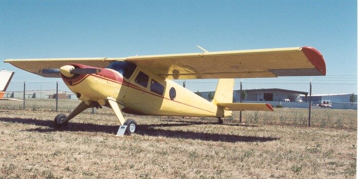

General arrangement is quite similar to Helio types, but the windows are smaller and the tall rectangular tail fin is missing. I'm sure I have this one somewhere, but I'll have to dig further...
